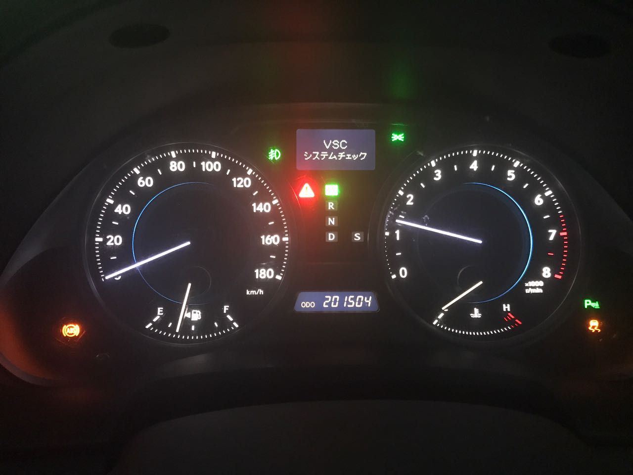

I just got this message yesterday when i start my car again.
The VSC got on , the ABS en the Slip got on.
I only disconnect the battery remove the Nav Unit , change the hard drive then put it back in and put the battery back on.
Online i read about talking both connector off and let it overnight and connect it back in the morning.
i did that and still everything remain the same.
I Scan the Computer and got these error.
P0517
C1336
C1203
C1223
Am searching now online to see what these Error can be
