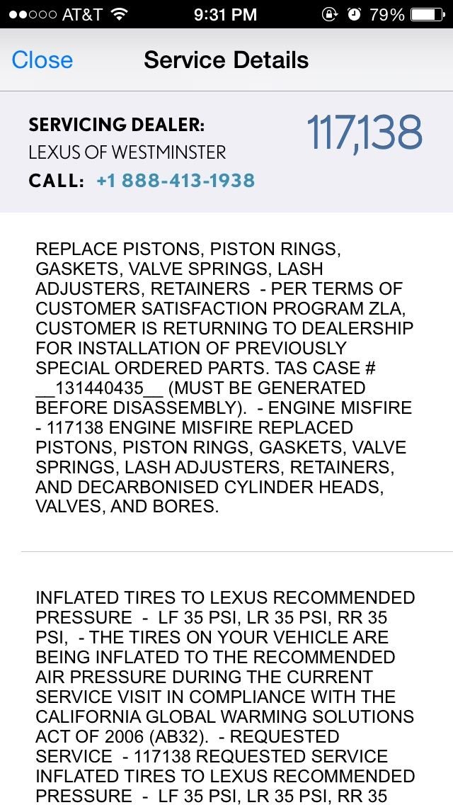

really? its a 2006 is250 and i know of the issue but was unaware of the inlimited miles/years, also i bought the car used and i am pretty sure the original owner had that done at the dealer (i'll attach a pic of service records) not sure if thats what was done or not. thank you!

The year is not unlimited ... I think it might be 9 years; so check your service records on when the car is sold to a person. Also, what you posted looks like the carbon build up fix. When was that done? Normally, the Lexus dealership will warranty their work for 1 year and some number of miles.
it was done in 2013 so unfortunately looks like out of warranty. also just called my lexus and the car is over the 9 years so its out of the warranty for that too
