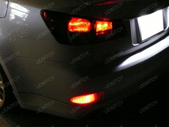

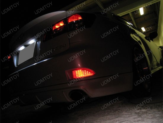

The wiring is for the LEDs are:
BLACK Wire - Negative
WHITE Wire - Running Light
RED Wire - Bright Mode
Connect the white wire to your tail light running light wire so it stays on when the tail lights are on. Wire up the red wire to your tail light's brake light wire so it gets brighter when your brakes are on.
