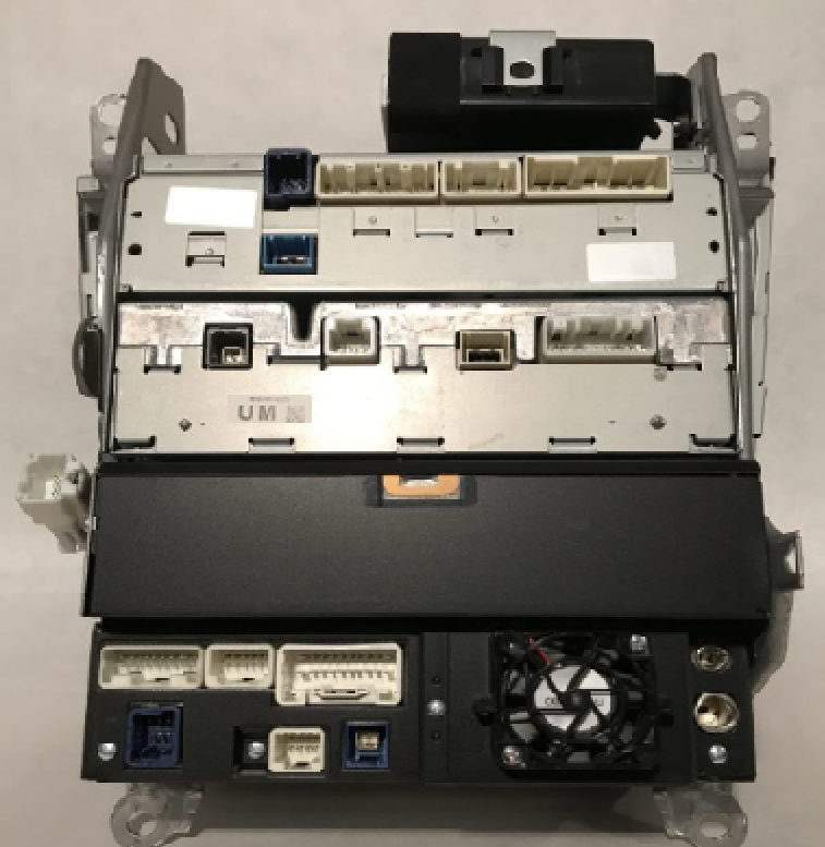

So I replaced the digitizer for my 2006 IS350 and the touch screen still doesn't work. Upon further inspection I noticed the power cable for the touch screen has a burnt mark on one of the pin slots(see attached picture). Is this the culprit? Am I screwed do I have to replace the wiring harness/socket?

Would you recall which port on back of the display assembly the damaged connecter was removed from (Mark Levinson assembly shown)

It was the top right port and it's clean, no evidence of burnt pins. I went ahead and ordered a used LKQ unit to narrow it down and that ended up being the problem which is weird because in the picture the wire connector looks damaged but apparently it still works. I'm happy everything is working again. Thanks for your assistance!
