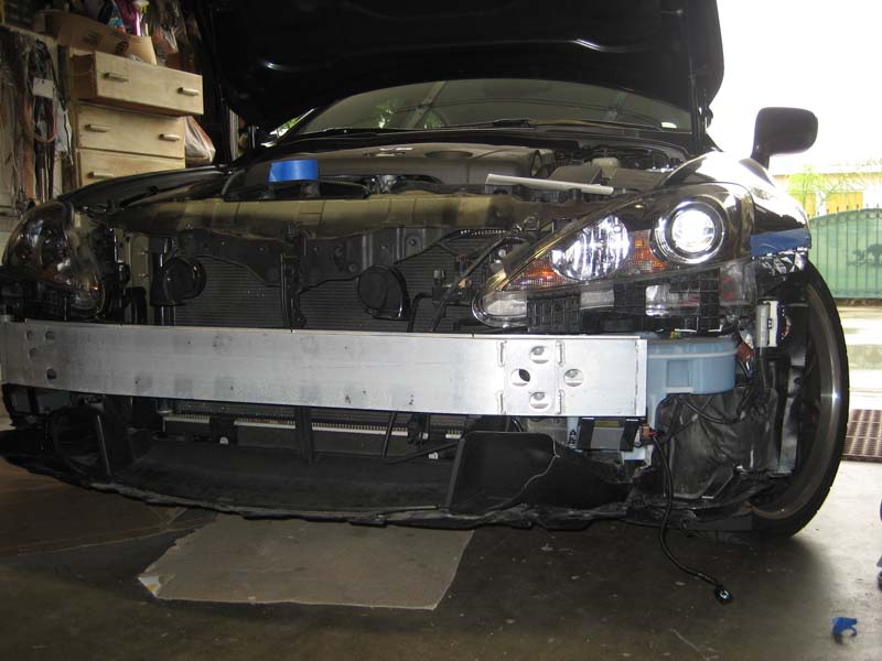

Location of the sensor, courtesy of JavyLSU
Photo of sensor installed on car, courtesy of ULTiMaX99

Just checked my car, and the sensor is clearly visible through the lower (honeycomb) grill opening.
