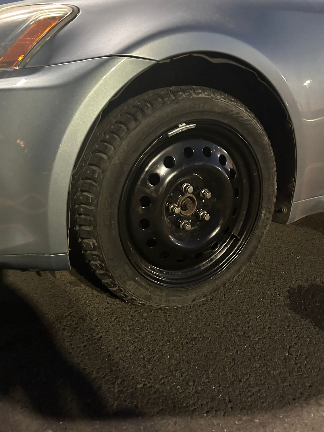

Hello, I am looking to get some steelies for a winter set.
Will this size work for the rim?
7x17 +40
2006 IS 250 AWD
225/45/17
Yeah it should work.
I have 225/55/17
With 8x17 +45
Mild rubbing, nothing serious.
So yeah should work

Thank you.
I'll order the wheels and keep you guys posted.

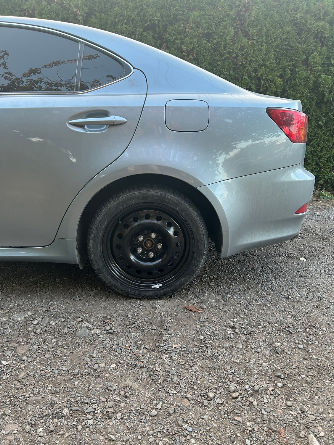

Default They worked..
They worked out great. They look similar to cops' car wheels, but the wheels stick out a little bit further to the outside.
I got steels wheels from eBay for about $411
Nokian Hakkapeliitta Studded for - $497
installation - $113
total cost - about $1040
