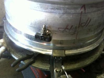

Check out 'banding' as well. Basically a giant hose clamp you use to attach the TPMS to the barrell of the wheel. Works perfect..just make sure your tire shop knows they are there for any future service on the tires..or they can snap them off very easily
Works like this
