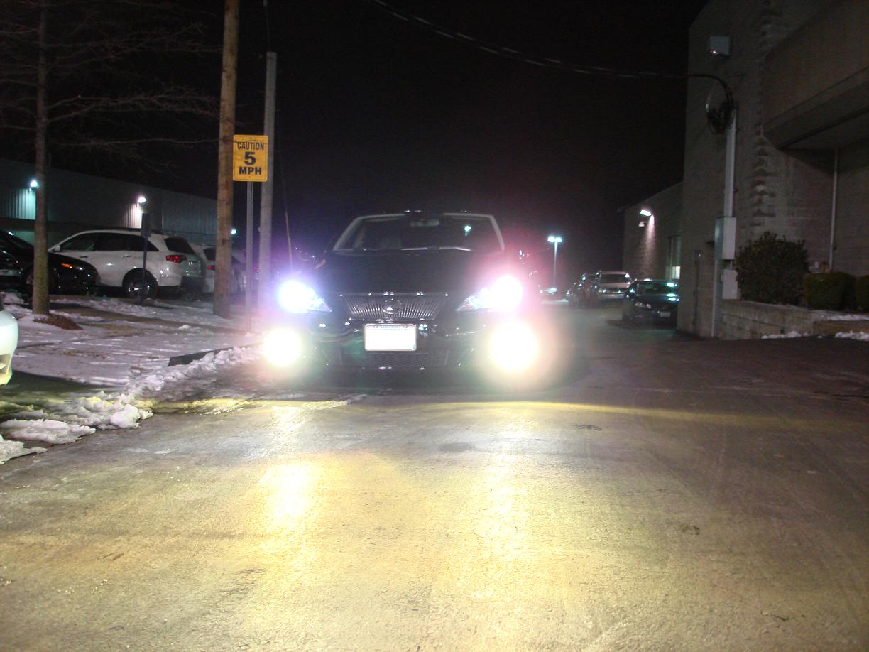

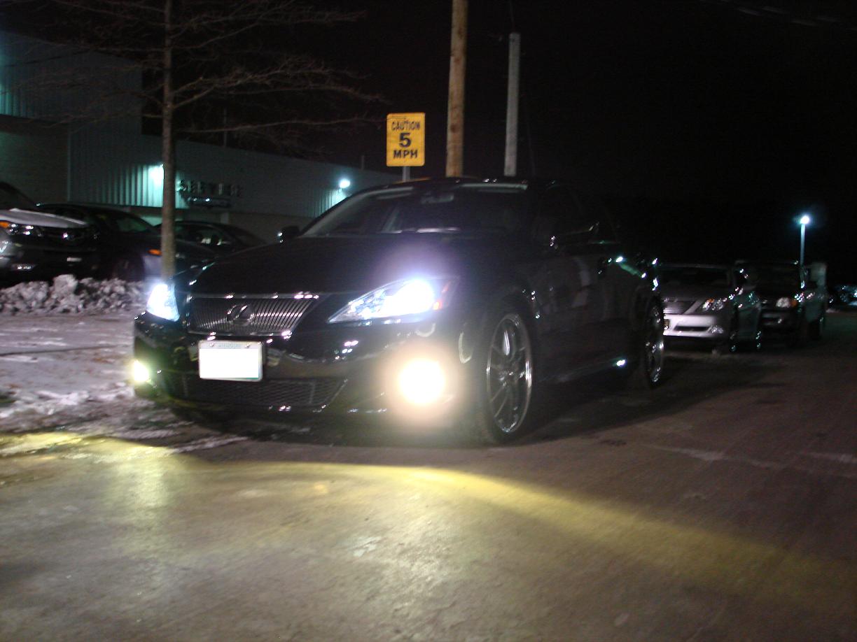

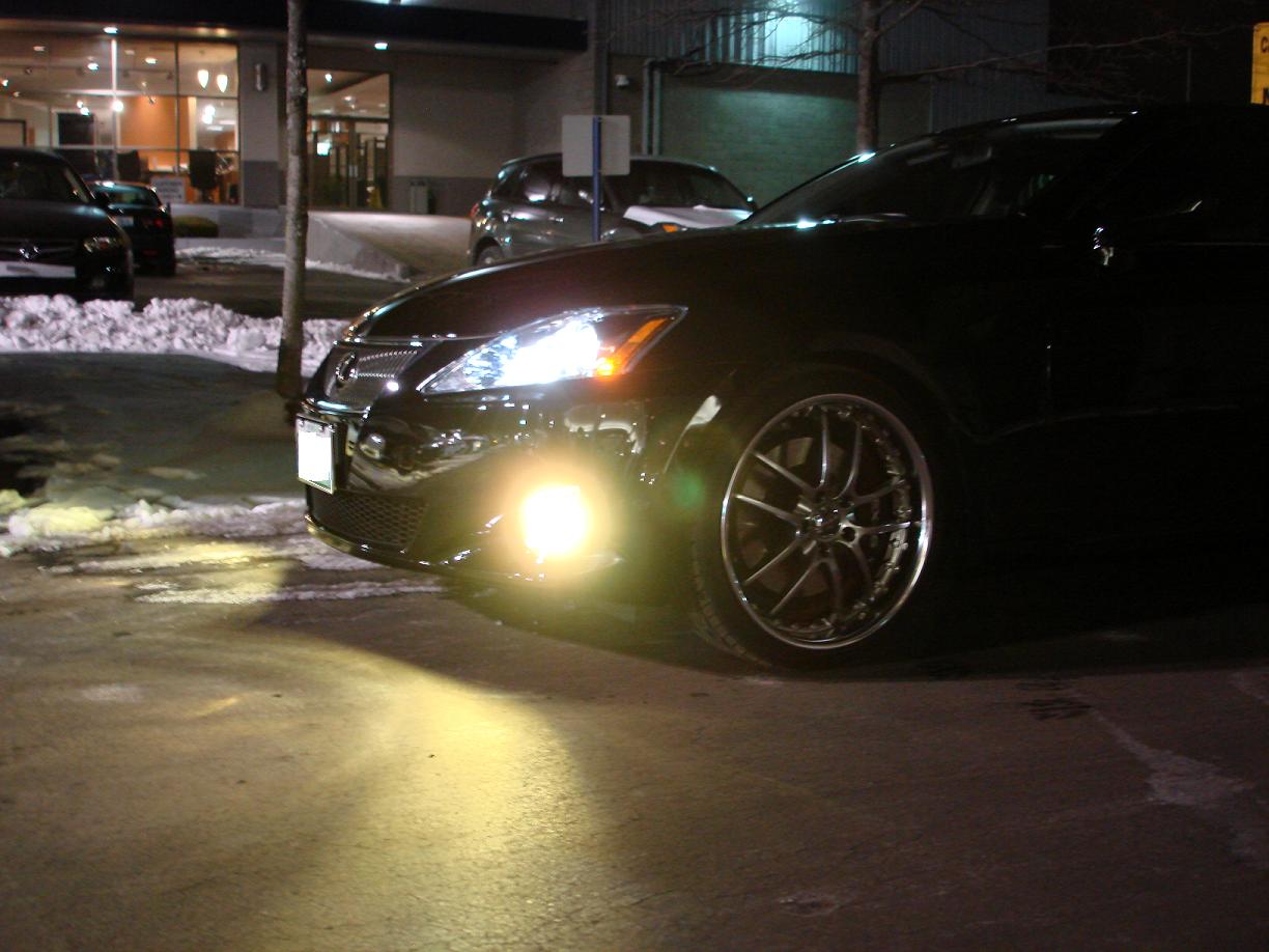

Here are just a few quick shots of the HIDs from Xenon Depot. It's the Xtreme 3000k kit. Unbelieveably bright!
Sorry for the fuzzy pics...it was freezing out tonight
