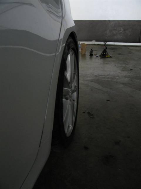

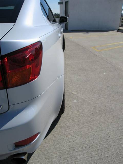

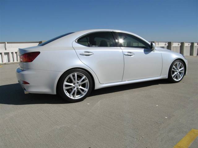

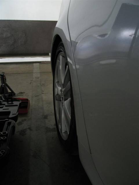

Here are some pics of my car after installation of custom-made spacers (17mm rears, 12 mm fronts). No rubbing, stock tires/wheels, Eibach pro-kit...
Before/After
Rear profile
Wheels straight
Javier

So this puts your offset front & rear at +33, right? Looks great!

wow that looks REALY good. how much and can u hook me up with that guy also so i can order some.
