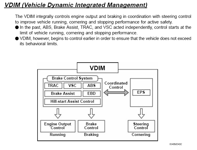

Here's a diagram also from the service manual that works with all the words above to help explain the operation of VDIM:
Javier
