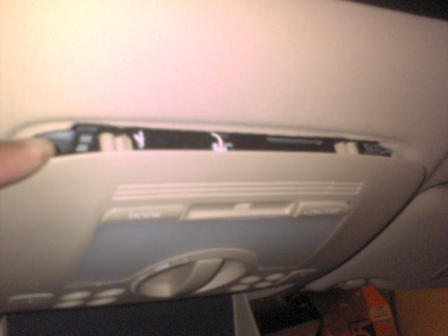

for the dome lights it easier. for the front dome light there are screws hidden in the sunglass holder
after you take out the 2 screws there are 2 plastic fasteners that hold the rest in. you can pull those out
there are 3 bulbs(194) they will twist out
finished product..you dont see it here but bc the led's are so close to the lens you will actully see 3 bright dots of light within the lens..maybe not if you get refracted led's
