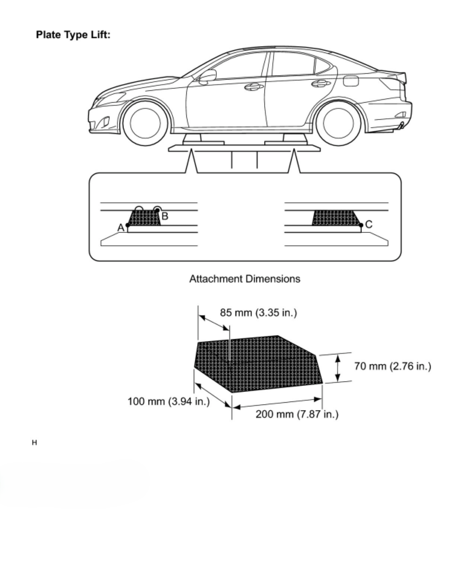

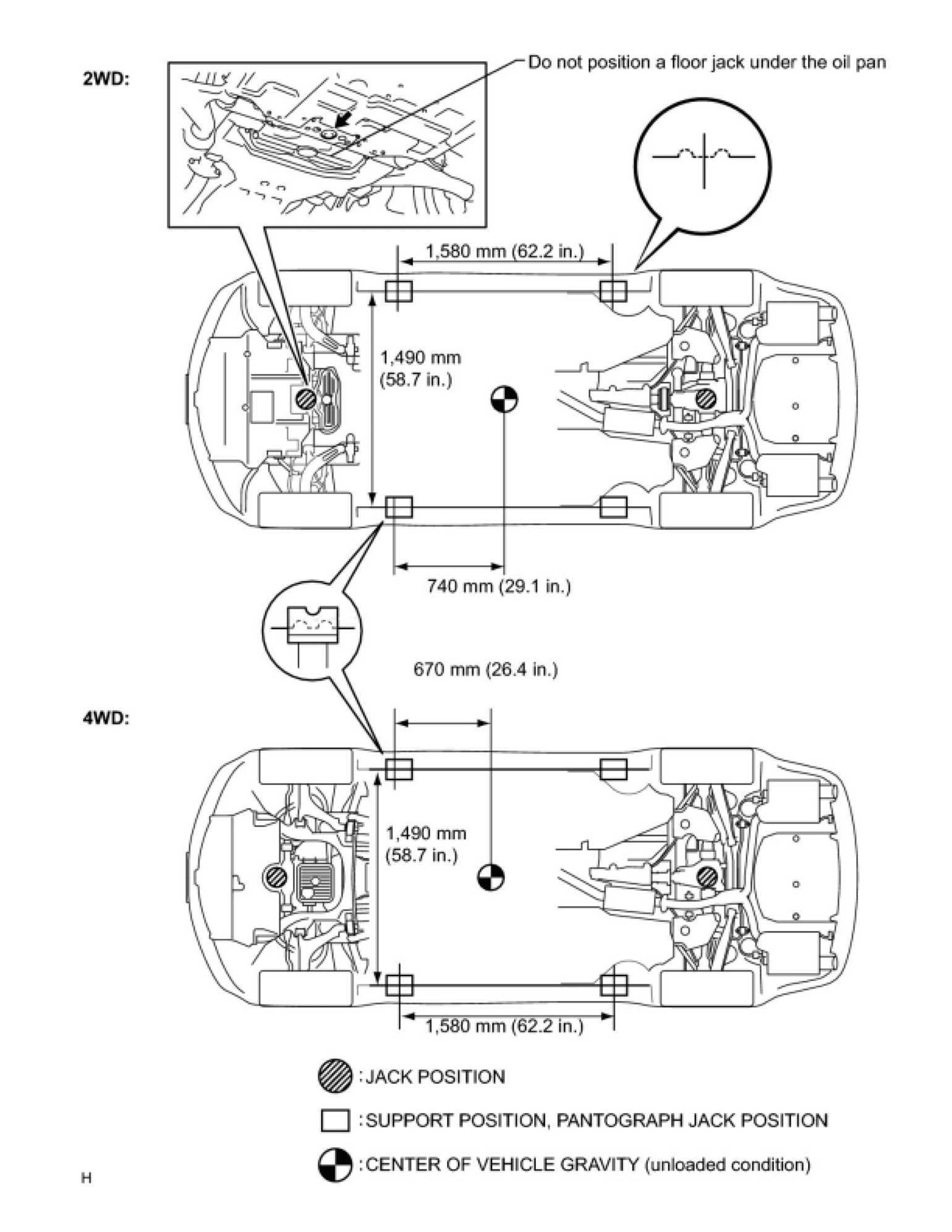

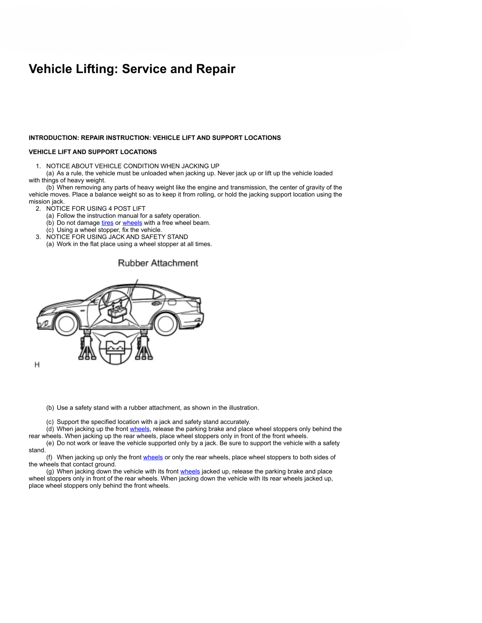

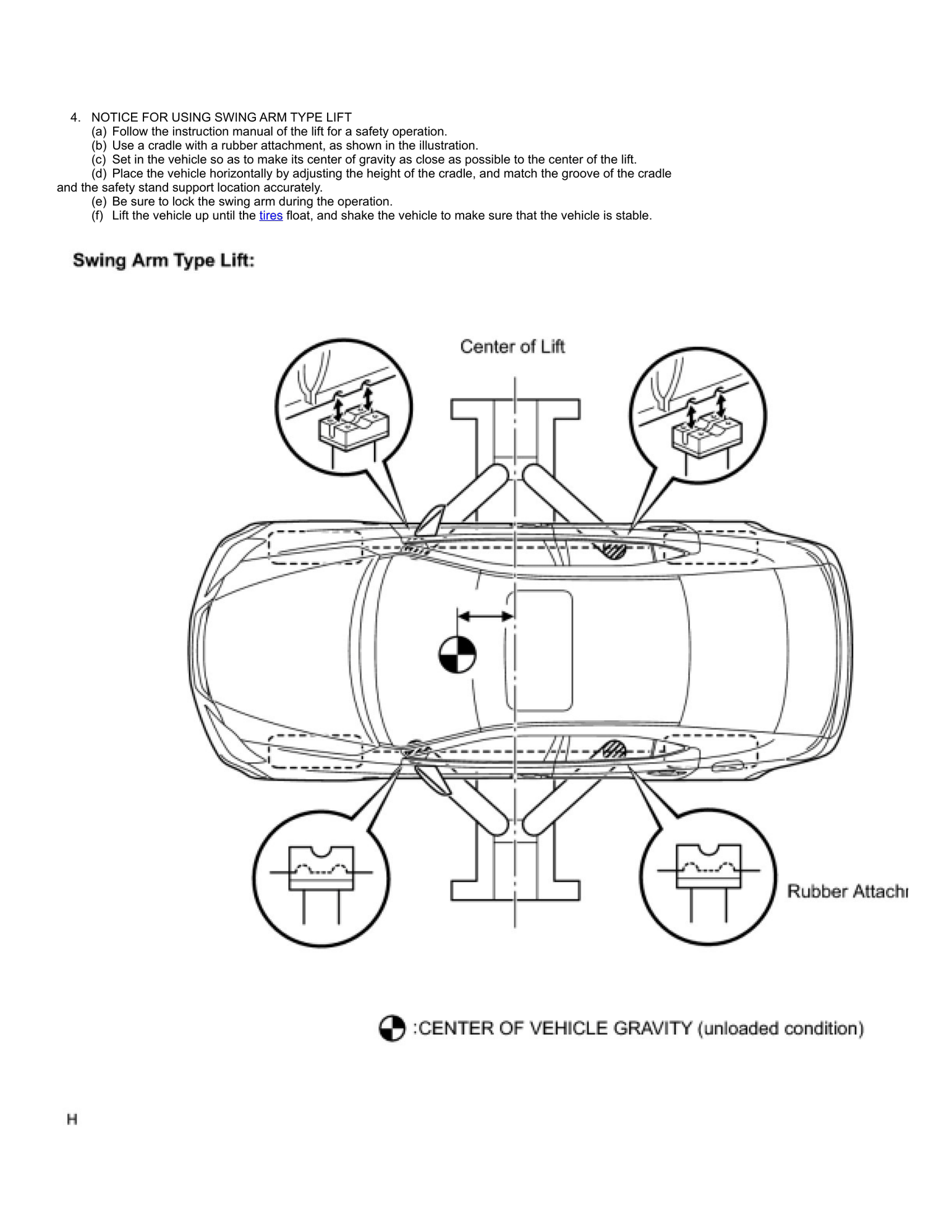

Here's the vehicle lift guide in the repair manual. Take some rubber pucks and line them up with the pinch welds, then jack the car up, and shove a jackstand under the subframe. If you're unsure please check YouTube, proper visuals may help more than a document, you do not want to accidentally send a jackstand up into the cabin.
