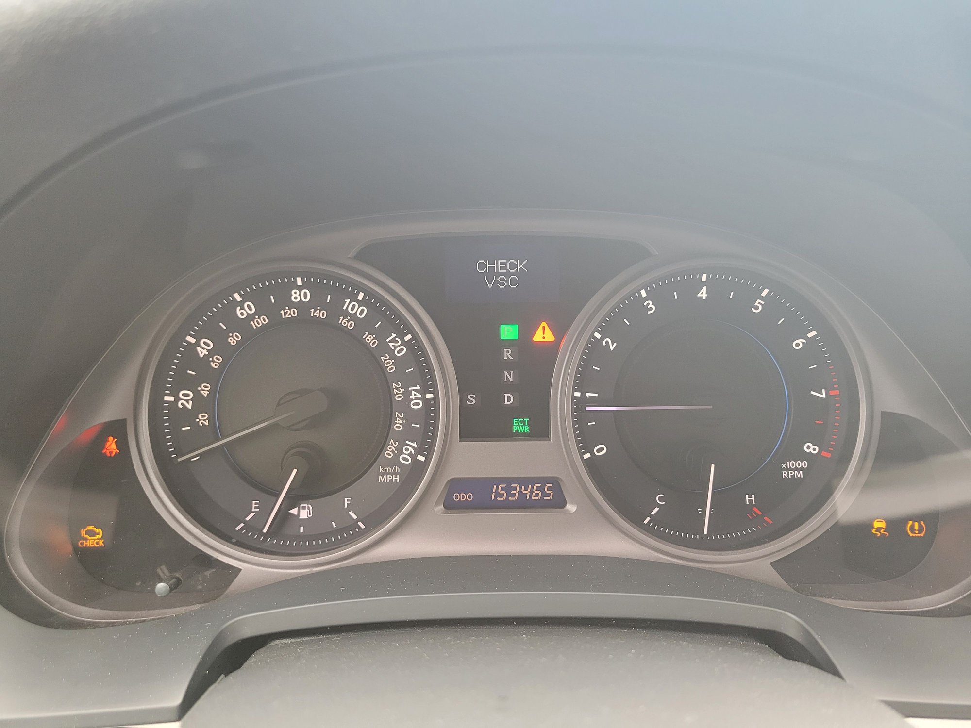

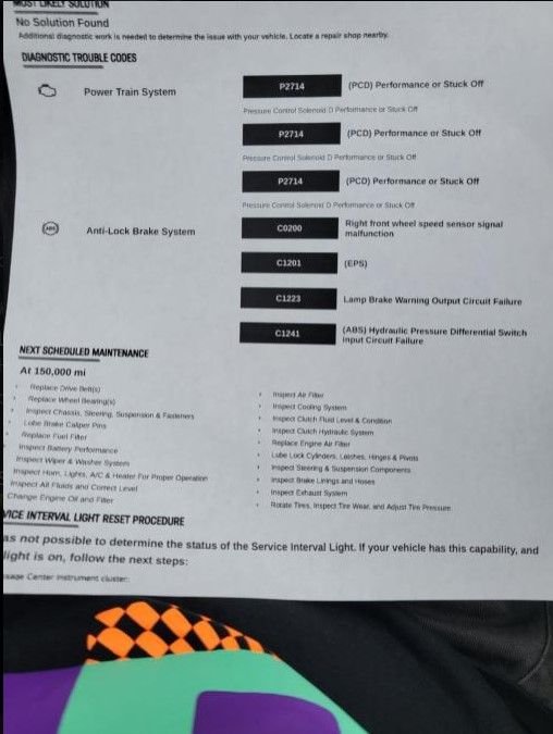

Hey guys, my lexus IS250 has the check engine light on and traction control light on, So I went out to my nearest autozone and had the codes scanned. A few codes came out, a few of them are repeated. Can you guys help me figure out whats going on, and the next steps I need to take? Thanks!
Photos below

The scan tool they're using is probably not using current specs. I have my old scan tool cabled that does the same thing.
As for codes normally these cars act weird if battery, or charging issues. To me Oriley's would be best have them load test the battery, and check your alternator. The one code for EPS requires major juice.

153K miles.... Has the brake fluid ever been flushed? It is part of the maintenance. You can get these codes if there is gunk in the ABS accumulator.
