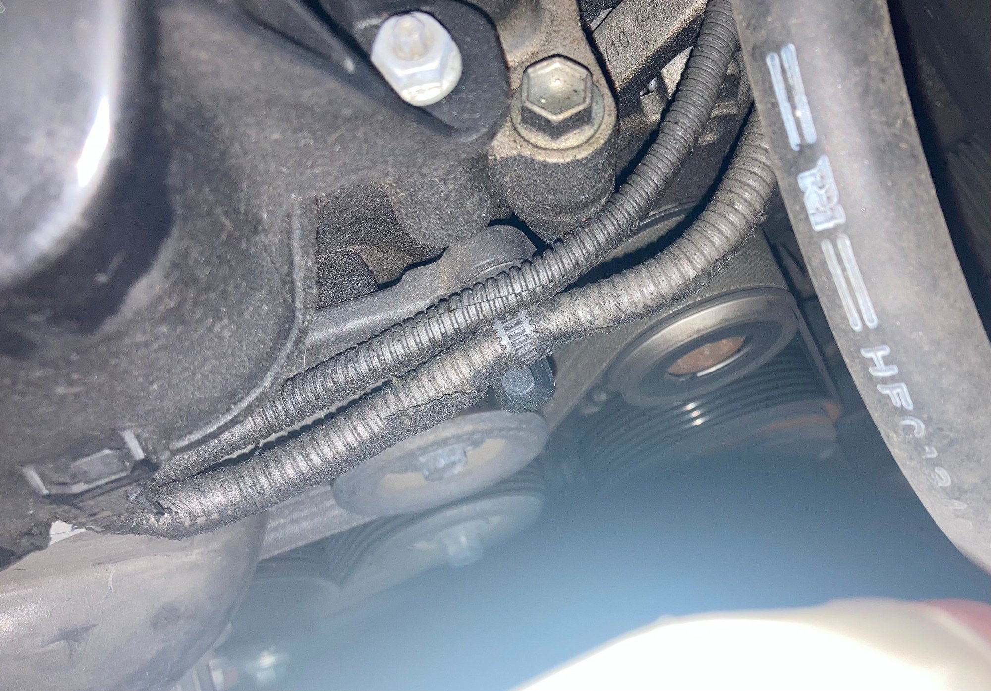

What is this plastic cover and why is the belt rubbing against this? Hopefully you can see it.
You need to:
- Make a point of finding the person who installed that belt/pulley, then
- Go give them a little rabbit-punch to the kidney to inspire them to be less of an idiot.
Definitely mis-routed, and looks like the wrong pulley. That may be your problem. Did you have work done recently? You may not have needed a battery or alternator. We assumed your belt was at least installed correctly.

No work done recently. I think the belt was on correctly before. I took it back to the dealer and they put the belt back on correctly (I think). I told them I wanted a new belt and they said they would order me one. The only reason I even discovered this was because the customer service guy was trying to show me where they claimed that my valve cover was leaking and the tech said he thought the leaking oil is what killed the alt. I noticed the melted plastic and was like WTF. I didn't really see any oil. Is it even possible for that to happen? Of course they want like $900 to replace the valve cover seals and they said I need rear brakes for like another $600.

Before discussing anything else, get the correct pulley and install the belt correctly. I think it may be the correct pulley, the grooves that appear are in fact, not truly grooves, but rather transferred rubber from the belt being installed on the wrong side.
can’t diagnose anything before fixing the serp belt. Since it is clearly too loose, it is probably the source of your problems. Probably. See the link already provided.
