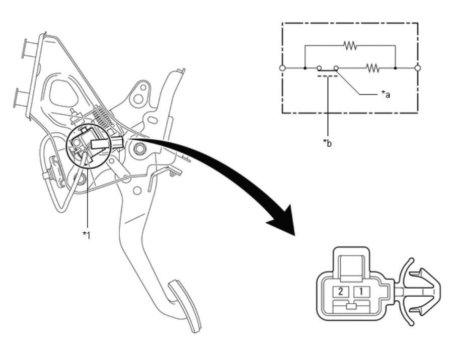

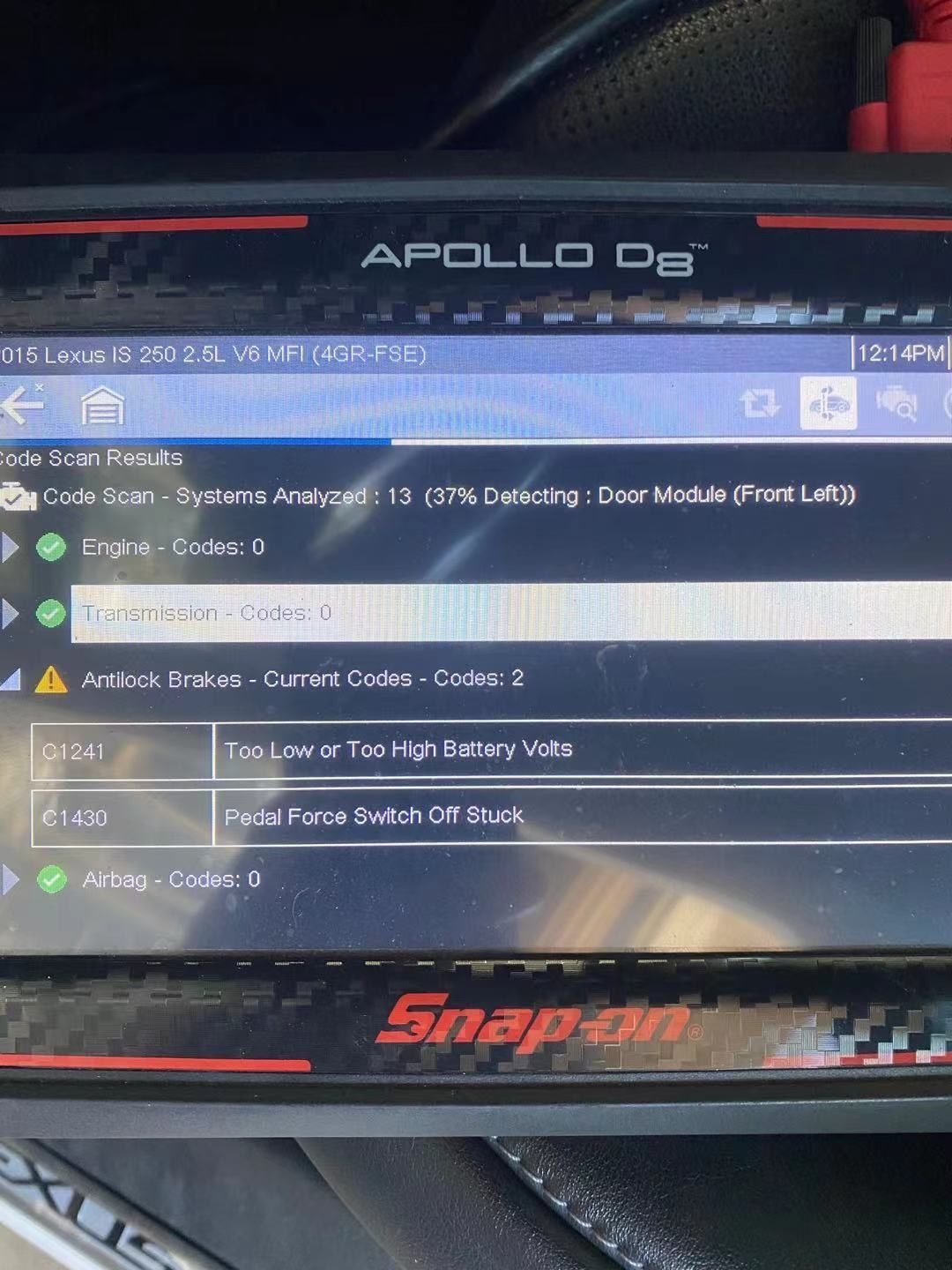

I believe the code description for C1430 in that scan tool is slightly confusing. I checked service data and found the following description for that code:
The brake pedal load sensing switch is built into the brake pedal support assembly (and is different from the stop light switch):
Hope this helps!

Does it mean that I only need to replace the brake pedal support assembly to resolve this C1430 warning code?

Before changing any parts it would be worth checking the attached procedure. Was there any work done in that area around the pedals when you first encountered this issue?
