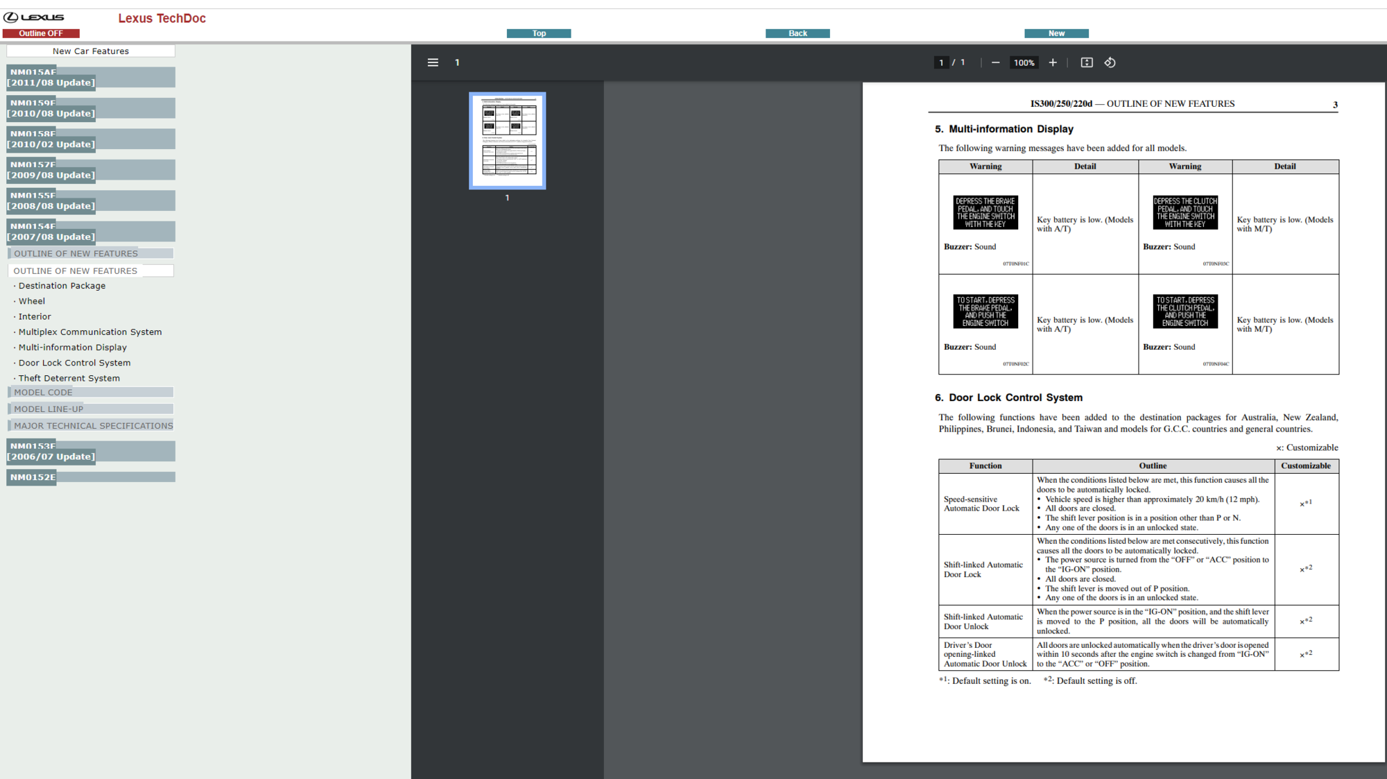

From what I've gathered, it seems that American models had it from the beginning, but European models only received it with the 2007/08 update.
Armed with this knowledge, I set out to find out what part actually needs to be upgraded. After looking in the repair manual, it turned out to be the Main Body ECU RH, located in the Cowl Side J/B RH, behind the glove box.

After turning on the ignition, I was surprised to find that none of that happened. Everything seemed to be normal, so I went ahead and tried the procedure for auto locking doors described in the US owners manual:
Disappointingly, this did nothing. However, not all hope was lost: I fired up Techstream and entered Customize Functions for the Body Control Module. Lo and behold, two new options appeared: Auto Lock and All Unlock/Open-Close:
After setting them to on, I went for a drive and everything seems to work perfectly! The doors now lock automatically when going over 20 km/h and all the doors unlock after opening the driver's door.
