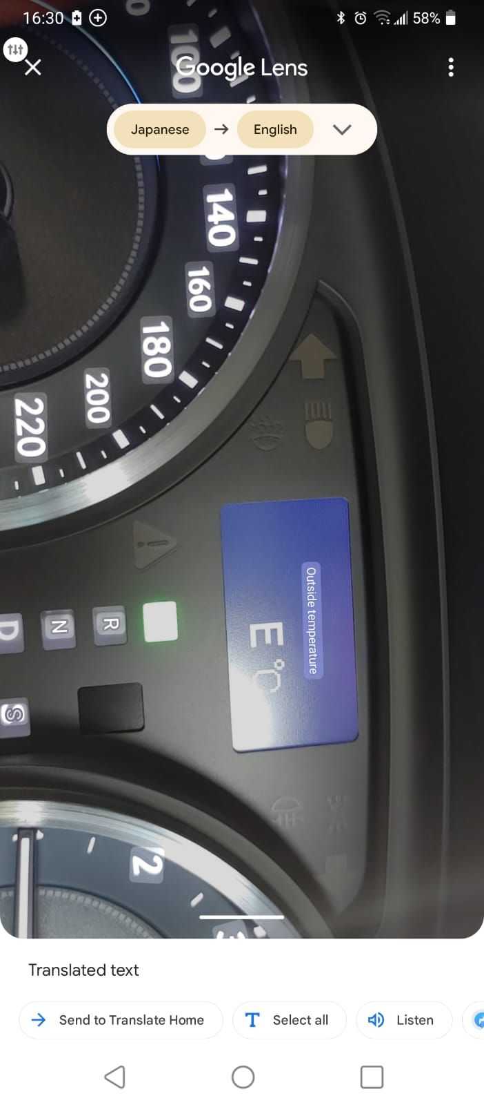

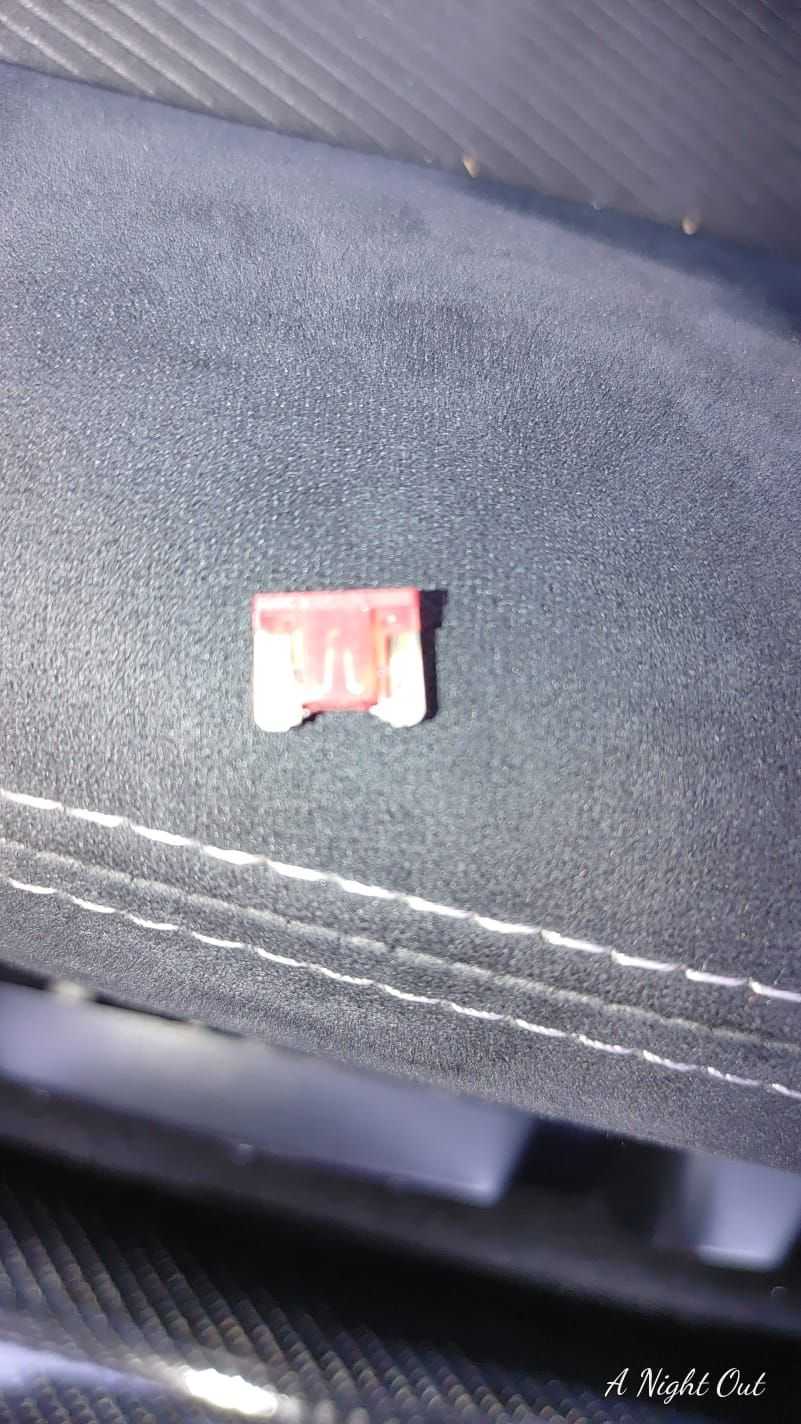

Hello again, I appreciate your time and brutal honesty, keep it coming. As you request i pulled more than 10 fuse and found 1 broken fuse under the passenger side as shown in attachment (10A ECU-IG LH), all fuse under both the driver and passenger side all the fuse had continuity and a 0.2 - 0.3 Ohm resistance, I even went in the engine bay with the same results. I replaced the broken fuse with the same ratings but no change in my problems, all the lights that was previously on such as steering, ABS, traction/stability are still on as shown in pics below, I even went into techstream and did a health check on all 28 ECU but u0123 & u0124 remains as shown in pics below. If you also noticed the Air conditioner and park assist module has an asterisk which denoted the module is missing, you can correct me if im wrong.
Shows the lights on dash
No lights on A/C module
Fuse that was blown ECU-IG LH (Fuse was replaced with same rating)
Blown fuse
Message when I try to ruin my A/C
No reading for outside temperature
When I do individual health check on park assist
When I do individual health check on Air conditioner
Asterisk showing modules are missing ?

Pic of broken fuse (10Amp)
ECU-IG LH (location of broken fuse) Fuse was replaced from spare (10Amp)

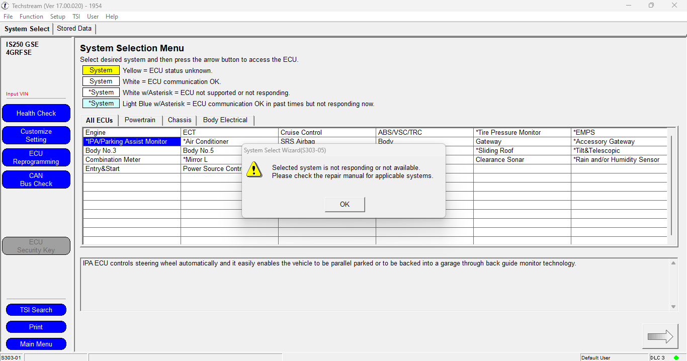

Next I went into techstream and ran a health check on all 28 modules and results were U0123 and U0124 remains, I tried to clear but they still remain.
Asterisk next to modules that indicates they are missing or not being seen
Individual checks of module with results as shown
Message on screen when I try to operate my A/C
No outside reading of temperature
A/C controller does not light up, radio works, navigation works (pretty much everything else)
These are the lights displayed on my cluster when i start my engine before and after broken fuse was located (same results)

After your above instructions I went back on my own and did some physical inspections of the fuses in the the cabin where I tested for continuity and resistance and found one damaged fuse, it was the ECU-IG LH fuse on the passenger side box (Right hand drive) 10A fuse, coincidentally that fuse was over the A/C, Power steering, ABS, ESP. Shift-lock, all of which I was having issues with. I replaced that fuse with correct and exact rating but no change. I went to try and clear the U0123 and U0124 with a "certain software" that i wont mention and the DTC code still remains, I tried leaving the battery terminals off for 1 hour, no change.
