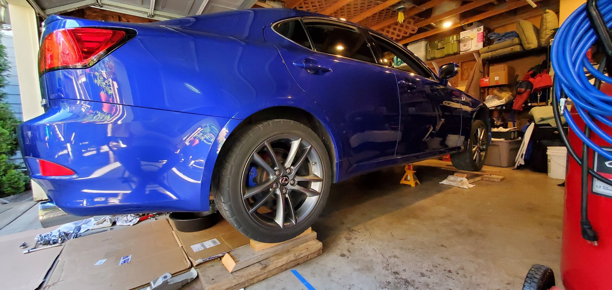

This past weekend I drove it up on 2x6" for clearance jacked it up by rear diff with a 2x4" between the jack and diff. Sat it jack stands using 2x4" at box frame under the car to swap the rear diff for one with LSD.
