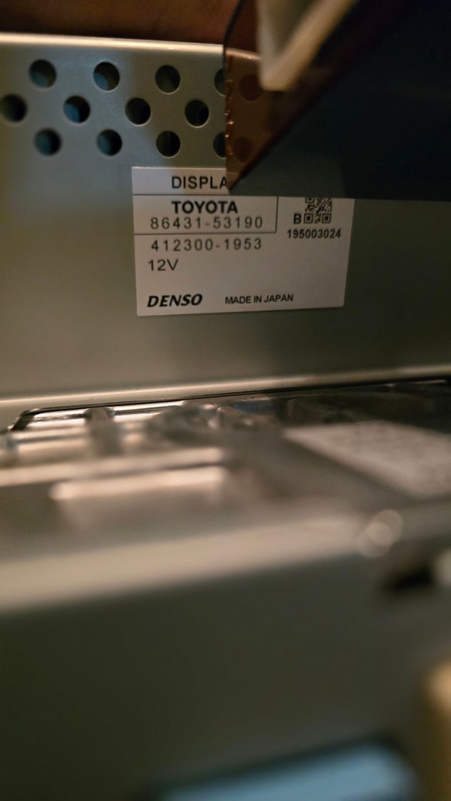

Not sure if I should add to this thread or start a new one -- looking at getting an Android head unit installed in my 2010 IS350C. It has Navi, but I don't think it has ML sound.
I first ordered a Phoenix Automotive tesla-style unit -- looked great, but many bugs in the software, hazards stuck on, and support was slow and inconsistent. I eventually had to do a chargeback as they wanted me to pay return shipping on the defective unit. Wanted to love the unit, but the company and support was really disappointing. Can't seem to talk to anybody except tech support, so that became a non-starter.
Tried an amazon chines noname unit instead, came with the wrong harnesses -- so that one likely has to go back as well.
I'm reading this thread about the Teyes unit, and sounds like its more well known and perhaps a better option. I'm trying to figure out if it'll fit my car given the harness issue I had with the second unit -- how can I tell if I need "A" or "B"? Maybe I just didn't find the info that explains it. Just want to make sure if I'm ordering off Aliexpress (I'm in Canada) that I'm getting the right unit the first time around, or if it won't fit, I don't waste anybody;s time and expense.
I'm also wondering about backup camera options -- does this unit support wireless? Because I have the 350C, I'm concerned about running any wiring back there for an aftermarket camera. I've seen wireless backup camera options, but not sure if the head unit needs to specifically support that. Again, any suggestions appreciated if anybody has experience or knowledge with this.
Finally, any other units that are recommended? My main thing is to add Android auto to the car, the factory head unit is dim, scratched, and dated. I don't want to overspend given that the need is pretty basic, but they seem to range from $200-$1000, based on RAM, storage, and accessories. How much RAM and storage do I actually need? Does it make a difference on performance etc?
Sorry for all the questions. Just taking a third try at this so hoping I'm asking the right questions this time around. I've attached pics of the front and back of the factory unit, the labels I can see on it to identify the components, and the factory connectors I have in case they help.
Thx in advance for any help on this!
