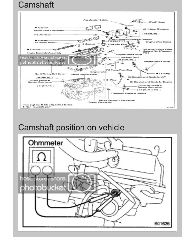

I have only saw p0340 I think it was random miss fire that was a while back this car seems fine up to 3500 rpm and than starts to hesitate and the further u press pedal it gets worse just lays down and than runs fine again up to that rpm could be bad injector but put a stethoscope to each at idle and they sound the same good luck
Old Jul 6, 2019 | 08:59 AM
PrisyCrisy's Avatar
PrisyCrisy
Joined: Feb 2016
Posts: 161
From: South Carolina
Camshaft connector location
I would start by replacing the connector. Order a new pigtail and crimp wires to pigtail. The connectors go bad in these cars after awhile. It could be a bad pin, so a cheap easy way to possibly fix it would be to start with replacing that plug.
