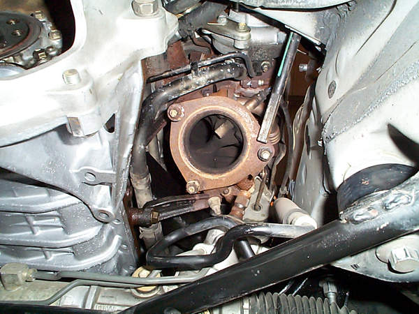

std turbo set up down pipe, will be going soon, in the trash
