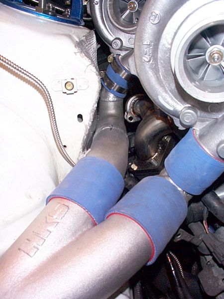

DOWNPIPES
REAR WASTGATE
TURBO MANIFOLDS
TURBO DOWNPIPE
INTERCOOLER - INLET MANIFOLD
TURBO - INTERCOOLER
TURBO OUTLETS
Old Sep 14, 2003 | 05:41 AM
  #42
Richie's Avatar
Richie
Joined: May 2001
Posts: 19,103
From: Netherlands
It looks like a really tight fit with all the piping.

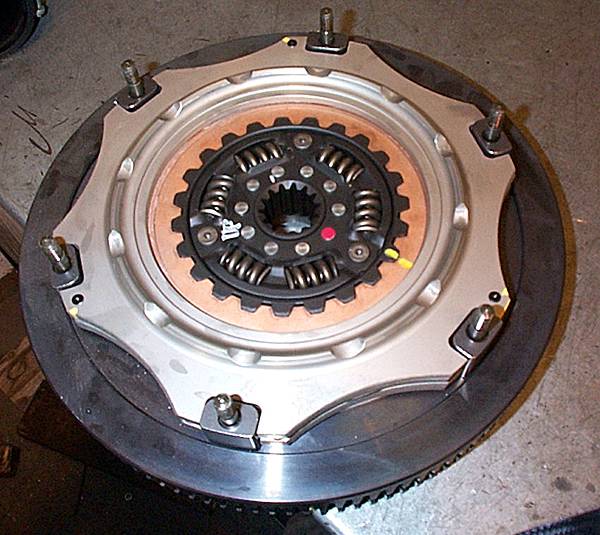

HKS Lightened Flywheel
HKS Clutch Plate
HKS Clutch Plate 2
Complete HKS Clutch and Flywheel Assembly
Old Sep 17, 2003 | 06:00 AM
  #44
Richie's Avatar
Richie
Joined: May 2001
Posts: 19,103
From: Netherlands
Looks like you guys are making some real progress lately !!!
