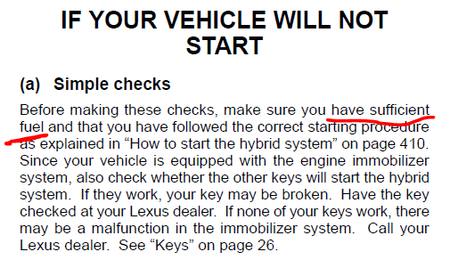

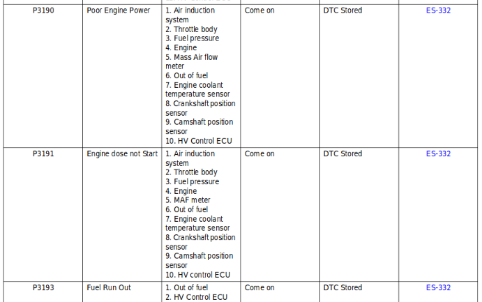

Ok don't laugh, plz see code P3193 below and confirm this is not your problem.
I have quarter level oil, should add some oil? but the HV ECU could be an issues since there was a hole in the tanks, I'm thinking it could also be a camshaft position sensor, or the fuel pump.
Out of fuel - are there steps to reset this module (HV Control ECU)?

Ok, I'm sorry I know it's obvious but I had to make sure you had plenty of gas first because of this code. lol
Not sure how long your car was sitting but I always start with the basics- a properly charged up engine battery and a couple gallons of fresh gas.
For the repair was the gas tank dropped or anything on the car unhooked anywhere?
