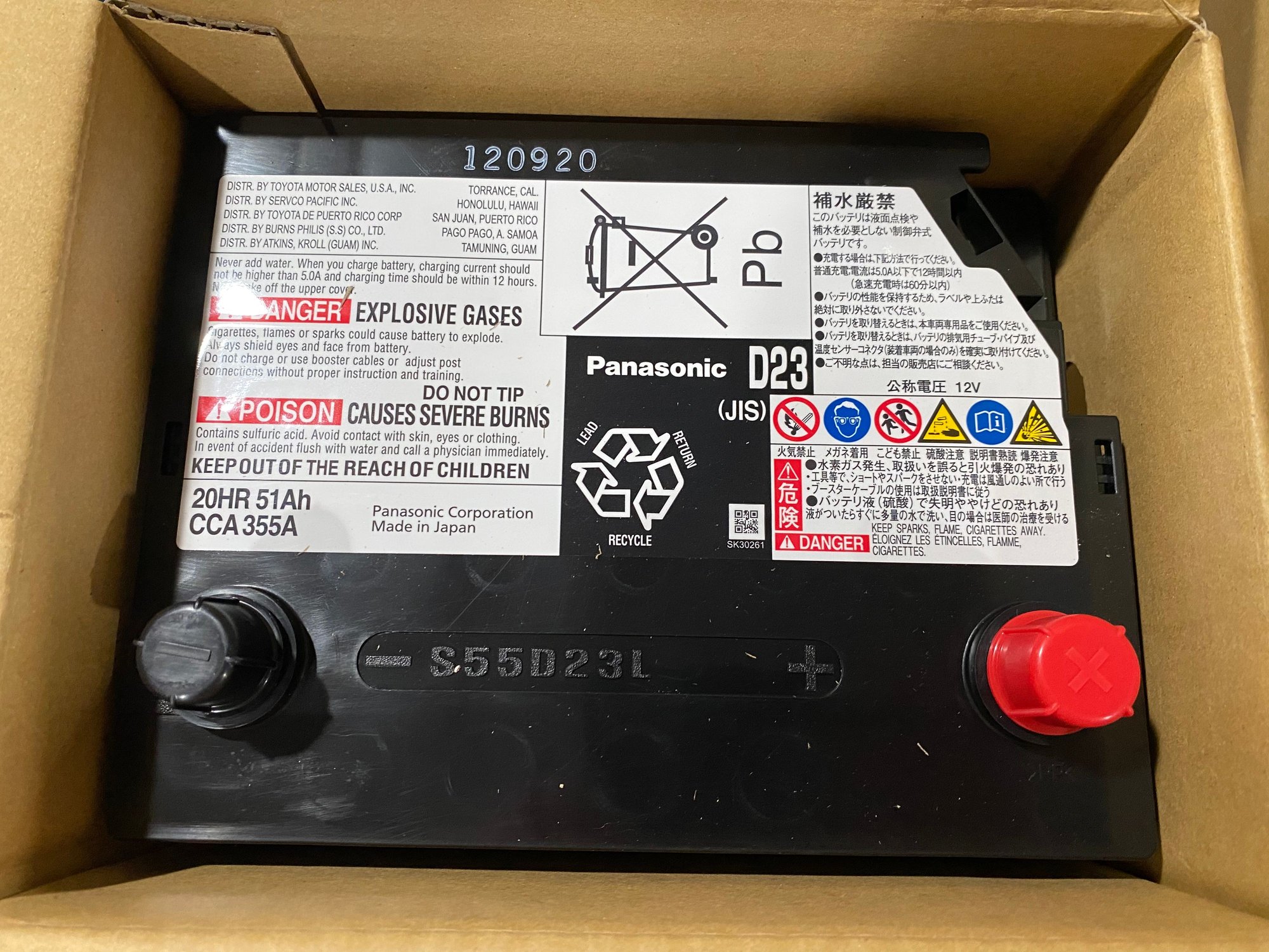

As a result I went with the Lexus dealer option. New updated part number for a 2010 RX450h is 28800-31291.
Lowest price I found was through a Lexus online parts store (parts.lexus.com) as a pickup at my local dealer. Google the part number to find the best source for yourself.
As of December 2020 in NJ, USA I paid $256+tax for a Lexus battery. I was originally quoted as high as $422 before tax, so make sure to shop around.
Pleasantly surprised by the packaging. Didn’t anticipate the battery to come in a box.
Made in Japan by Panasonic. Date code indicates September 12th, 2020

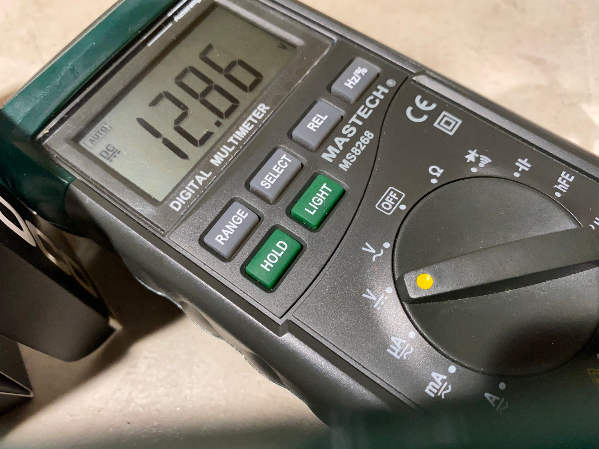

Initial charge on the new one. Old one tested at 12.1 after being fully charged and driven, dropped to 10.4 with a load tester.
Old one is nearly identical (March 26th, 2010). Very happy to have a Japanese Panasonic battery as a replacement - they’re generally regarded as the best long lasting batteries you can have in a Toyota/Lexus.
