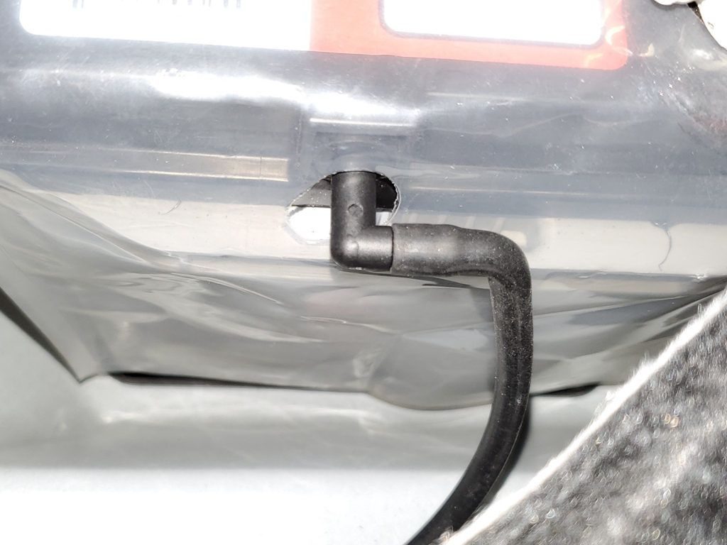

Finished the battery replacement today. Everything went smooth except the vent tube connection. The original tube elbow is too big to fit the vent hole of Champion battery.
Connect to a battery charger to maintain 12v voltage.
The original Panasonic battery (the battery bracket does not quite fit the edge of Panasonic battery)
Only need 10 mm wrench
Panasonic (up) & Champion (down)
The width of battery bracket
The length and width of battery tray
I used the sticker ripped from Panasonic battery to seal Champion vent hole.
Champion vent hole
The original vent tube elbow
The elbow is too big.
Finished. But the vent tube has not connected to the battery yet.
Update:
I saw a review wrote by a 2010 RX450h owner on pepboy website said the elbow of "Dorman 924-254 Battery Vent Tube" will work. I will update after I receive it from Amazon.
Update:
Finally had time to finish the job, the elbow of "Dorman 924-254 Battery Vent Tube" works fine, and I also bought the vent plug from VW dealer, it costs $1 and maybe wait for a couple days to arrive. VW Battery Vent Plug. Part Number: 000915506.
VW battery vent plug 000915506

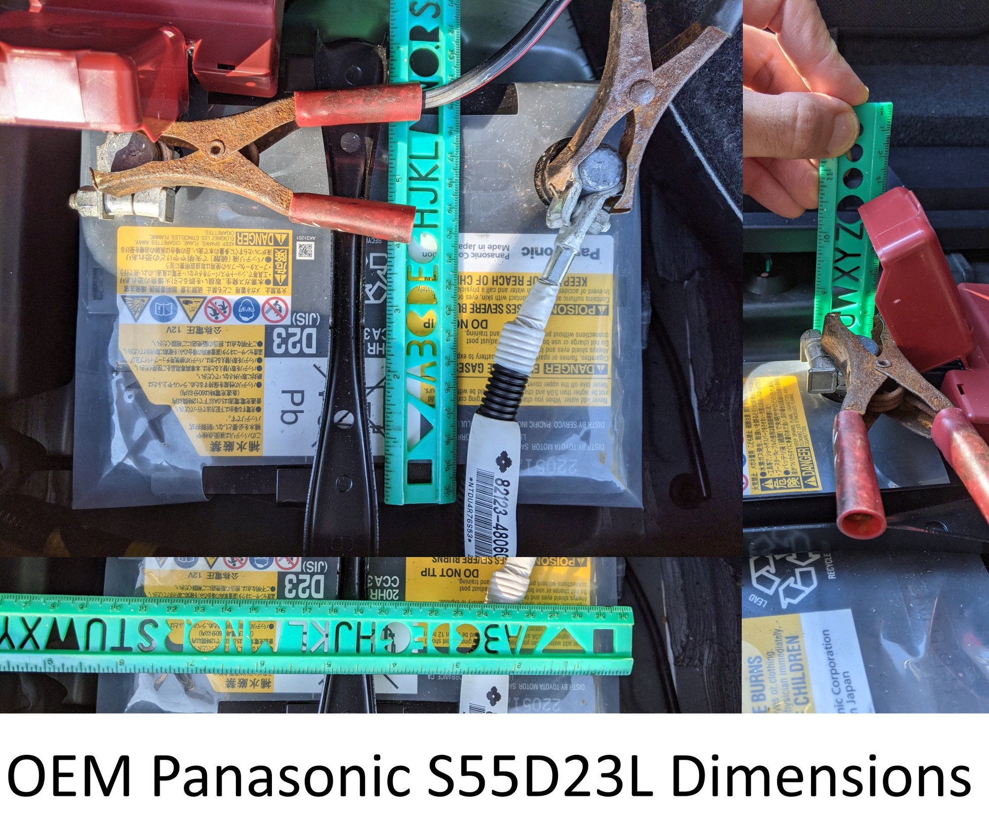

I ended up with an Odyssey Battery 96R-600, which is also quite expensive but IMO a very premium product and still about half of what the dealer wanted. Assuming the battery is AGM as specified with at least the same CCA rating and FITS you are good to go. The rest you can engineer around.
I installed the same Odyssey 96R-600 battery as a replacement for the OEM Panasonic S55D23L on a 2013 RX450h, a few days ago. The battery sizes are comparable, with the 96R-600 slightly shorter, requiring padding to be added between it and the top clamp. The 96R-600 footprint fit into the OEM battery tray snugly. The OEM battery label listed 51Ah 20HR, while the 96R-600 label showed 50Ah (and their website shows 52 Ah). The 96R-600 MSRP is $283.24, while an OEM replacement is $first-born-child.
I think that the slightly taller 64 Ah Odyssey ODP-AGM47 H5 L2 (47-650 (LN2-H5)) would also fit well. It's MSRP is $277.06.
Note that CCA probably doesn't matter, since the battery isn't used to start an engine, as I understand. More important is the Reserve Capacity (RC) or Amp Hours (Ah) to run electronics (while the engine is off), e.g., audio, lights, AC, heater, fans. Depending on how the vehicle and electronics are used, some folks are also concerned with how fast the battery can be recharged. (More info about RC vs Ah at https://www.sailnet.com/threads/batt...apacity.63682/ )
During install, I had a battery charger connected to the vehicle, to avoid possible issues with the vehicle computer forgetting itself. Not that I expected that would be a problem, but others have expressed concern.
Photos attached for the interested.
