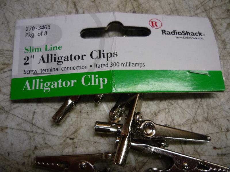

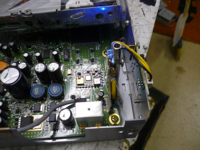

I'm in the process of draining the battery as mentioned above. Here's how I'm doing it:
Radio Shack Parts:
Alligator Clips
3.2 V LED lamp (2 prong)
I placed one prong of the LED Lamp on the + side of the battery and the other side on the - side. Clip to the battery using the alligator clip. Important Note: Use a piece of paper or cardboard in between the LED prong and alligator clip. Otherwise, you will short the + &- sides.
I'll let you know if it works!

Default More LED pics
Some more pics
Attached Thumbnails Please insert the correct map DVD-019.jpg   Please insert the correct map DVD-021.jpg
