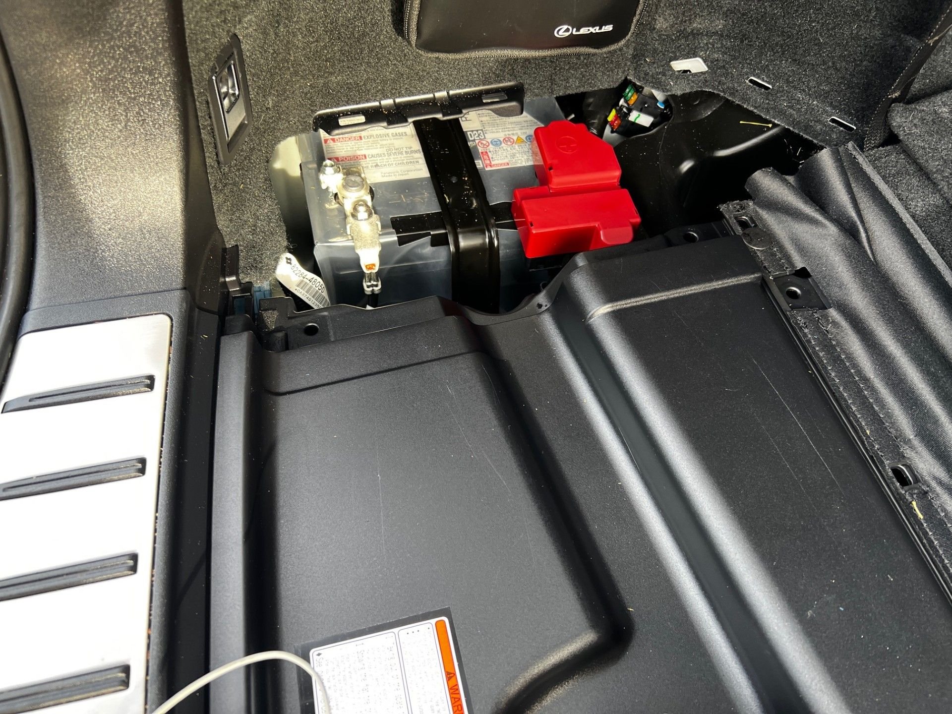

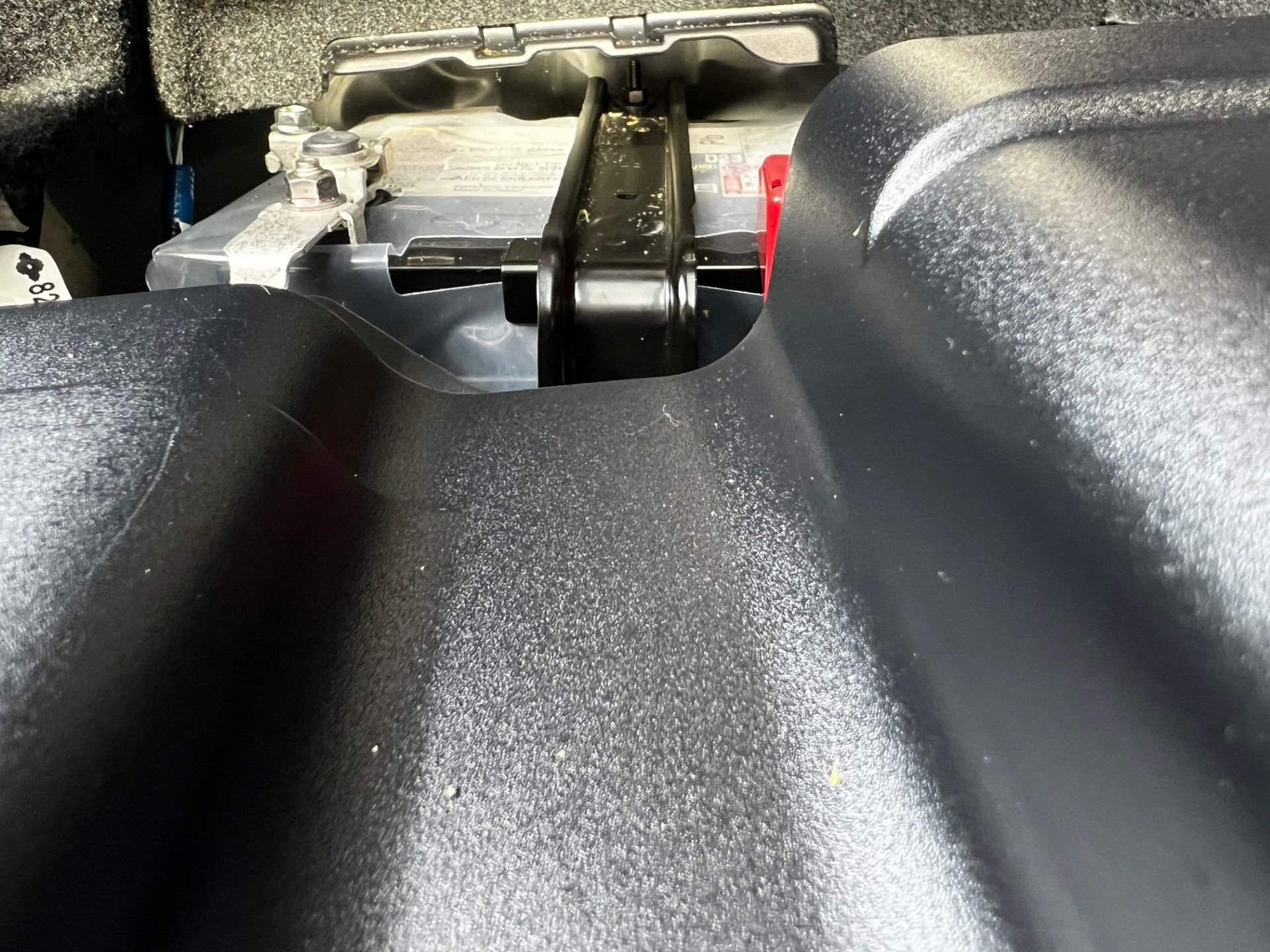

Old Mar 15, 2025 | 05:56 PM
tvarghese's Avatar
tvarghese
Joined: Dec 2019
Posts: 28
From: WI
Here are some pictures of the battery
Old Dec 19, 2025 | 03:43 PM
clicc916's Avatar
clicc916
Joined: Jul 2022
Posts: 15
You've likely solved this problem but wanted to post here in case anyone from the future decides to search.
The 450hL 12V battery is not commonly available at most auto parts stores (Auto Zone, O'Reilly's, Napa, Costco, etc.). You'll likely have to go to Lexus to get a replacement battery because it's a special Japanese format. If you're in a bind (middle of nowhere) and a normal H5 AGM is your only hope, I'm sure the electronics will work--it's just that the H5 won't fit nicely back into the rear corner without rattling and/or cutting some of the bottom bracket. The vent tubes from a 450hL also don't fit an H5 AGM battery.
The 450h does use an H5 AGM but I think the 3rd row seats require a smaller battery in the 450hL.

Old Dec 20, 2025 | 05:09 AM
tvarghese's Avatar
tvarghese
Joined: Dec 2019
Posts: 28
From: WI
Default Made some modifications to the holding bracket
Thanks for your response. I wound up with a slightly larger battery that has more power. It did not quite fit, so I had to make some adjustments to the bracket that held it in place. Yes, had to use a largish hammer to bend the metal into the size it needed it to be.
Went to ACE and got a barb that fit into the battery I bought. Sealed the sides with some silicone.
But it works so I'm going to leave it alone for the next 5 years or so and make any adjustments that I need to at that time.

Old Jan 6, 2026 | 07:16 PM
Six7Nine's Avatar
Six7Nine
4th Gear
Joined: Jan 2026
Posts: 4
Yeah, the L model battery setup is definitely tighter. You'll want the Group 35 battery, not the 47. The 47 is for the standard length RX. For that nut, a small socket wrench with a universal joint or a flex-head ratchet is your best bet to get in there at an angle.
