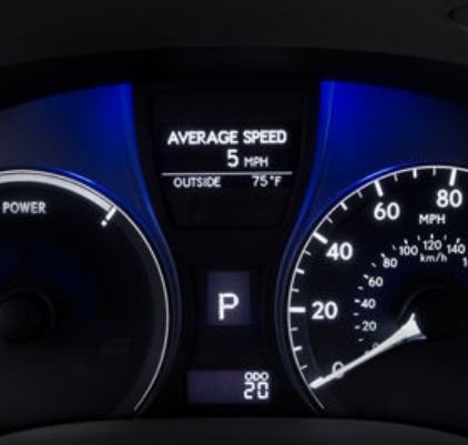

No good... the moment I checked out the little box, the instrument cluster and center display went dark, and now I can't start my car! It does not react when I push the start button. Power door locks, power seats and the power back door are working......

Can you please take a picture of the instrument cluster?
You may have accidentally turned the display level low,
"Does not start" ... Keep in mind 450H does not start ever ... it gets "Ready". or gets into Standby/accessory mode.

*Can you please take a picture of the instrument cluster?* - It's the same as the picture above, except that there are no instrument cluster lit at all.
*You may have accidentally turned the display level low,* - Great idea, but no, I can't move the gear shift lever and nothing in the instrument cluster indicates a powered engine.

Do attach a new/latest picture if things do not work out [full instrument cluster]. Also the status of security light.
