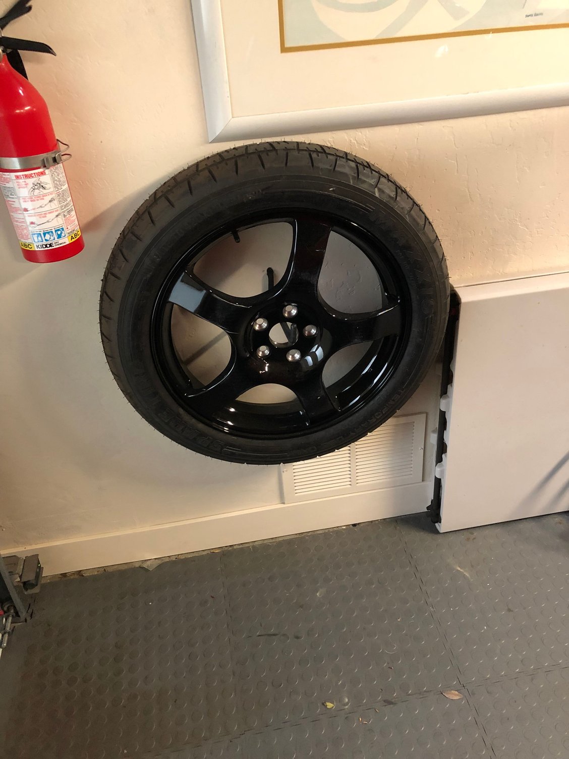

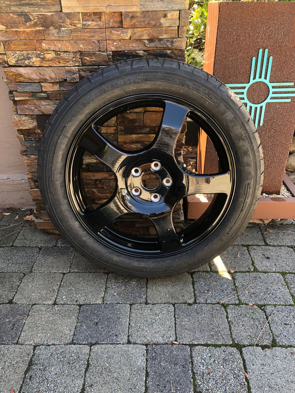

I finally bit the bullet and purchased a spare tire for my RX. I considered the Modern Spare 18" wheel and tire but, finally opted to buy an original Lexus spare from a salvage yard on the east coast. It's a 20" alloy with a Maxxis temporary spare mounted on the wheel. It is somewhat similar to the Modern spare and from looking the tire over, it appears to have never been mounted on a car and used. The description stated that it was from a 2023 RX350. The casting on the back side of the wheel has both the Toyota and Lexus logos so, it would seem that this combination of wheel and tire is used on multiple vehicles under both marques. It was $280 with no additional charge for Fedex Ground shipping to my house. I don't really plan to carry it around all the time and would only do so when we take a longer trip.

I picked the spare tire and wheel up on eBay, from August Pohl Auto Parts for $280 with free shipping. It was from a 2023 RX Gen5 and appears to have never been mounted on a vehicle. Checking their current listings, they do not seem to have any others at the present time. Right now, it hangs on my garage wall.
