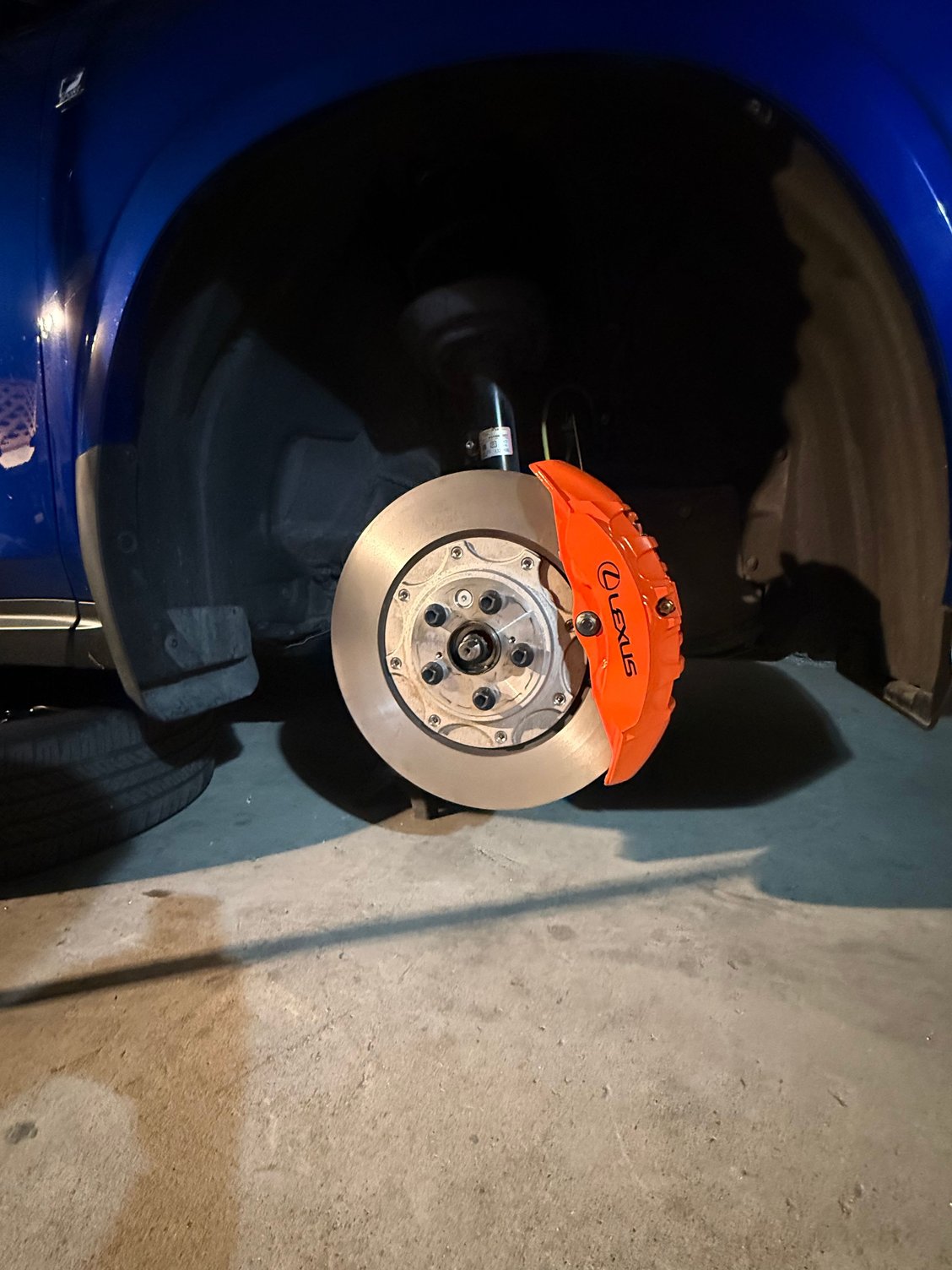

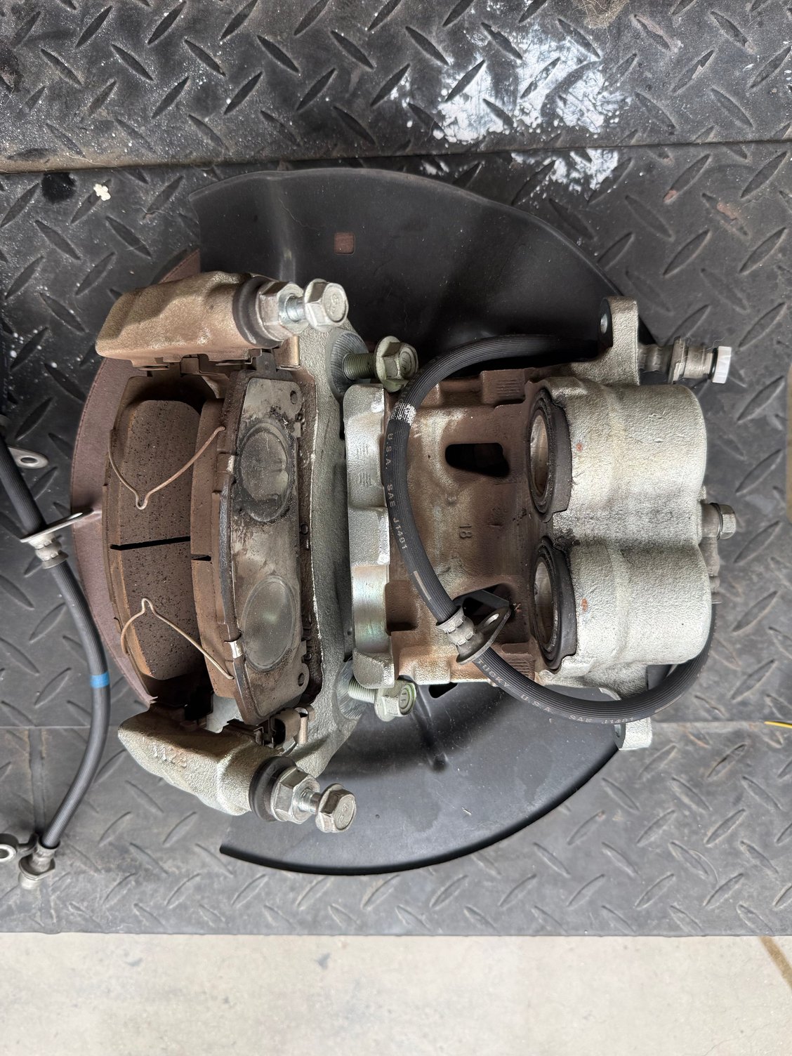

Default Upgraded my brakes on the NX
I put RX500h brakes on my NX. It surely stops better when towing ~2000lbs than my old oem brakes, I’ve heard of places to get towing recertification over seas.
