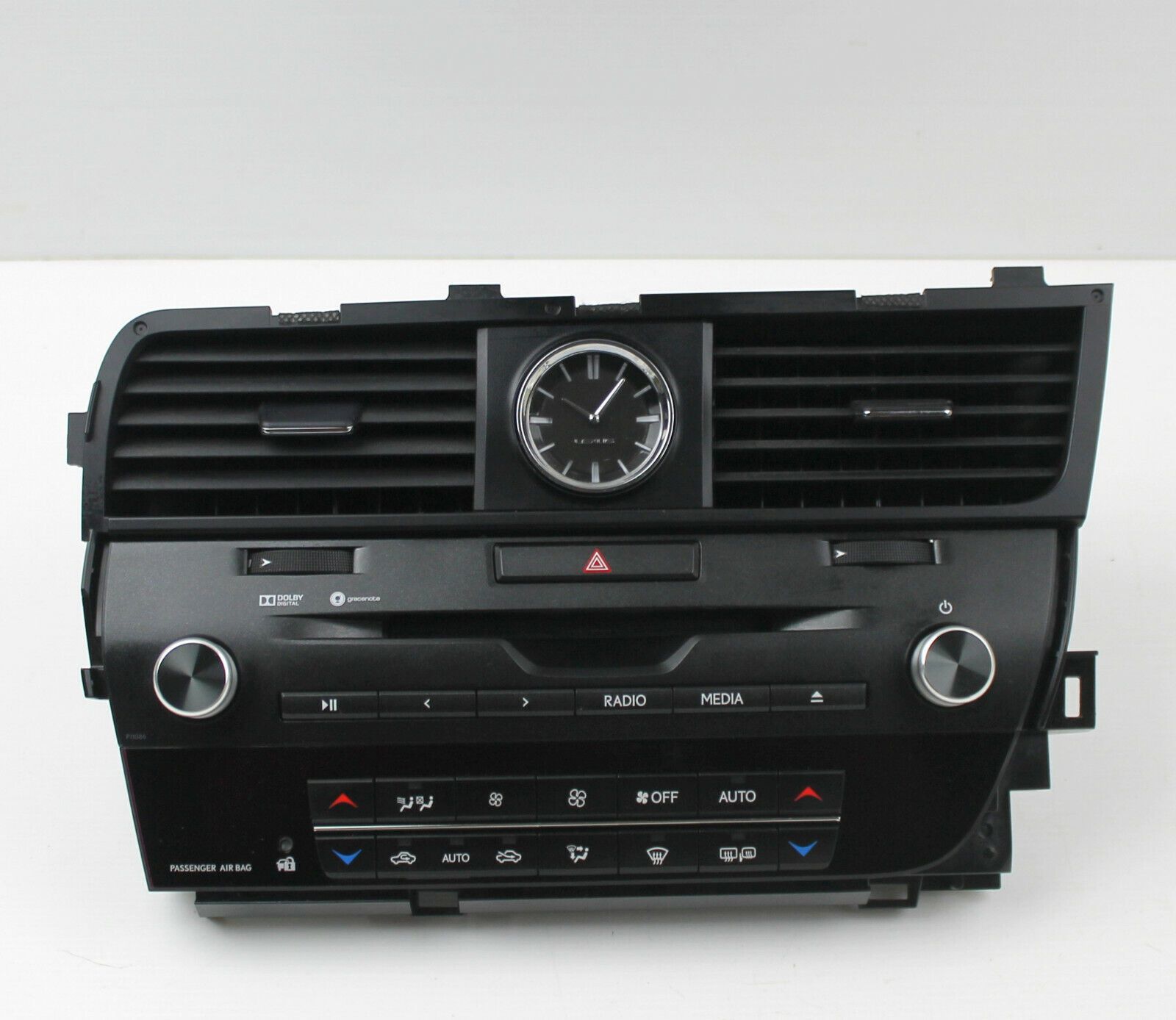

Car Play isn't available on mine either. Just uploaded the closest picture I found on Google Images to describe what i meant by the infotainment system which was changed; incase i was getting the unit name wrong. (Should have updated that, putting it in bracket).
I equally do not understand how the plug to the rear cam be causing a drain. Still yet to get back to me on their finding. Car now going into the 4th month with them.

They finally got back to me last week that the cause of the Parasitic Drain has been found. Apparently after changing the infotainment system and repairing some wires(not sure why, car is still not so old to be wiring repairing) they concluded its the ECU behind the radio malfunctioning.
ECU Changed, they monitored for about 2 weeks and confirms the drain in no more... Halleluiah!
BUT... After i took the car off them, i realised the climate control unit in front of the ECU is totally dead and not working. I told them and they said I can use the controls on the Infotainment system to control climate for now while they order another Climate Control Unit
