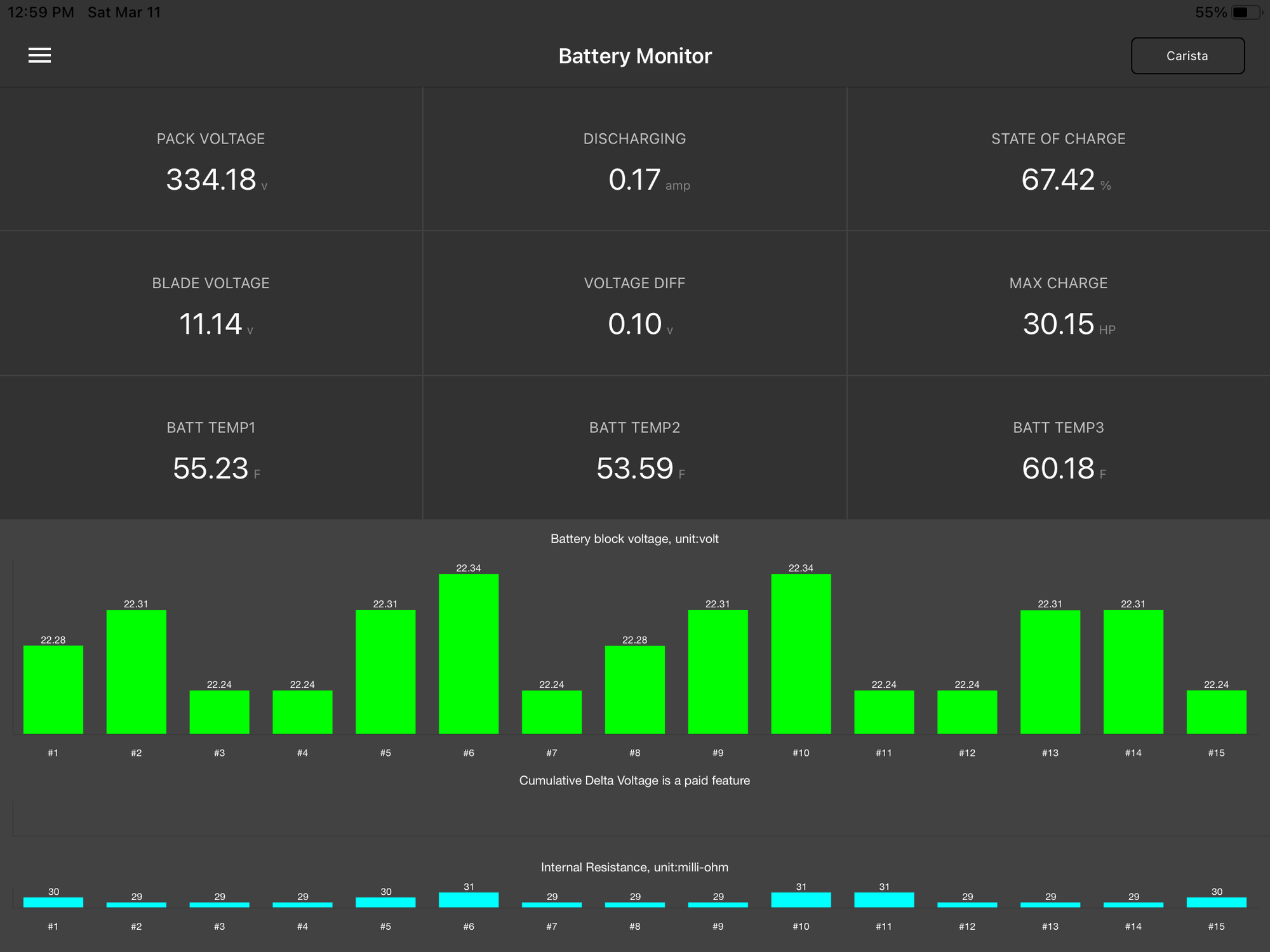

Originally Posted by gamma113
Has anyone use Dr Prius App? Is it accurate to determine the life of the traction battery?
It’s interesting to see the battery specs, really cool when driving , as you can see real time discharge and charging rates and voltage diff, which seems to be the true value of battery health overall.

Old Mar 20, 2023 | 09:00 AM
ThreeCW's Avatar
ThreeCW
Joined: Jun 2022
Posts: 36
According to the Prius App website link below, the Viecar (used to be Carista), is an acceptable Bluetooth Scan Tool.
I also now see that Roscol is using the Carista scan tool, as shown in the top right corner of the picture he posted.
