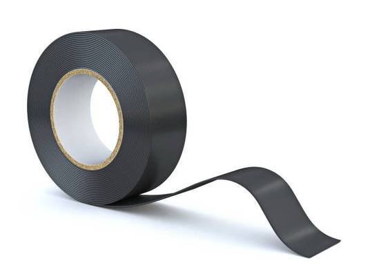

Yes they should fit, same center bore, same widths, same tire size compatibility. Only difference is the Camry wheels has a higher offset, so it will be "sunk in" by 6mm.
Couldn't tell you about the TPMS though, I have a set of HL wheels on an RX350 and it different MHz between the two SUVs, so TPMS won't work.
At 400$, its a deal, and just ignore the light with some black electrical tape and occasionally check the pressures...

This was my dad's solution to the HL wheels... Just check the tires periodically.
