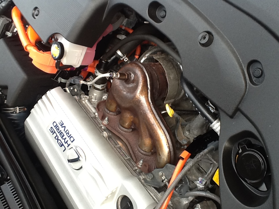

New owner of an HS Premium. Very Happy.
Question: The manifold on almost all of the HS models looks like a rusty manifold off a barn find 1938 Hupmobile.
Will high temp paint work? Has anyone done this? (Photos Please)

I agree with you. Under the hood, you have a real nice engine cover, but what take up most of the real estate is that rusty manifold right there front and center.
If you knew how much that thing costs, you'll use maximum caution as you try to beautify it.
But if you try, maybe the Rustoleum 2000 deg. F flat black might work. Post pictures.

Airman, thanks for the tip. Used the 2000 degree Rustoleum. Primer base, then flat black. Big improvement.

^^^ Big improvement! Did you sand it down first to remove any superficial rust?

Yes Corrado, did prep by putting solvent on ScotchBrite pad, then steel wool until smooth. Then I took a rag with isopropyl alcohol to remove oils and remaining particles. Masked, then followed directions on primer and paint. After a week. Still looks good.
