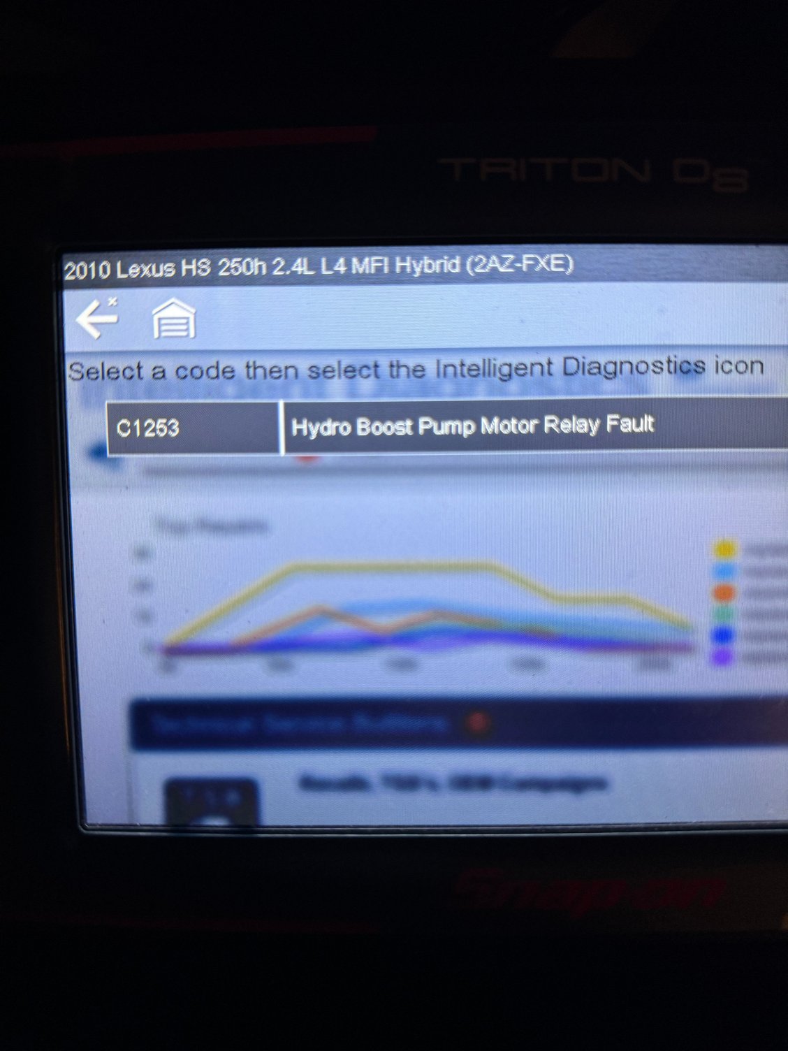

Got the letter about the CSP for brake booster and this car has been having booster issues for years there’s this hissing noise when you step on the pedal, and the pump cycles every 10-12 seconds like clockwork regardless if I’m on the pedal or not is this code enough to have this repaired by the CSP? Just recently the car started to flash all the idiot lights momentarily while coasting and then when you step on the brake the feel is not right wife is scared of driving the car and rightfully so.

Yes it is time to take it to the Lexus dealer and tell them you think you qualify for the repair under the CSP. I think mine also qualifies and it is not nearly as bad as yours, just the occasional weird brake caliper noise.
For other CL members see this link for further details on the CSP (Customer Support Program 23LE04 applies to Brake Booster Pump Assembly and/or Brake Booster and is valid until March 31, 2024)
The last post in the link is a link to another thread that has copies of the actual CSP documents.

Thank you for the link. Sure is nice to have such a costly repair being done for free. Car is showing its age. Back in August I replaced a few bad cells and now I noticed the replace hybrid pack DTC pending so I guess other cells are going bad as well. It’s also doing weird things like the trunk acts like I left the keys inside so it refuses to latch unless I really slam it. Other than that, the car is very mechanically sound. At 125k miles it still has the factory brake pads with enough lining to last quite a few more years.

Update: had the car serviced by the program and now I have a brand new booster and pump free of charge! Bad news is that the replace battery pack DTC is pending again.

I highly advise that you get it scanned first and be sure one of the codes is active. Lexus will charge you for diagnostics and not do the repair if the brake booster code is not active.
