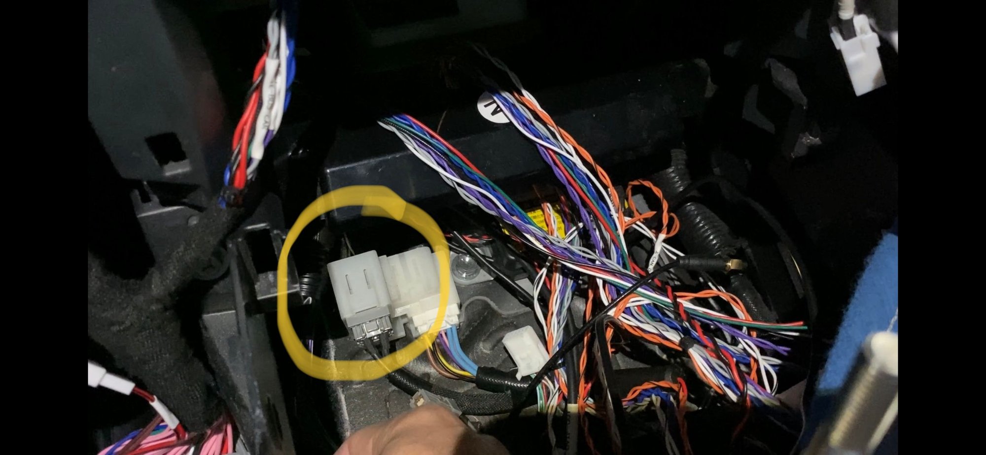

In an effort to start cleaning up everything before I was going to take it to Lexus to have them diagnose the issue, I adjusted some of the wires near the bottom of the center console, and the music magically came on. I froze for a good 20 seconds and thought really hard about the last few moves I made. I retraced my steps and found a wiring bracket at the bottom of the center console area to be the culprit. Here's an image that shows the bracket and harness.
It never occurred to me to test this bundle of wires because they were at the bottom of the center console, and I didn't touch them during the installation of the BeatSonic device. It turns out they are audio wires, after all. The gray one on the left was the problem; it wasn't making a good connection, so I used some electrical tape to make sure it sits firmly in its socket. Pretty sure it was the MOST communication connection to or from the AMP.
FYI, everything on that bracket is an audio wire, and if you unplug any of them, you'll lose audio.

I have the same issue with 2014 GX (and its intermittent) where is this bundle of wires? How do I get to it?

Remove your center console and dig into the wires until you find that bracket circled in the picture above, and give it a giggle. It could be the culprit.
