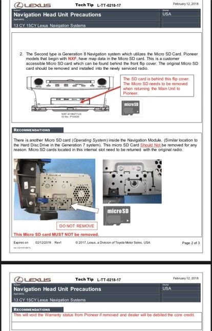

I noticed the OS is controlled by a micro SD, so maybe that needs to be replaced. Worse case is a chip on the motherboard has short circuited.

Thank you for the suggestion. For the request to cover the unit under TSB, are you referring to L-TT-0272-19?
