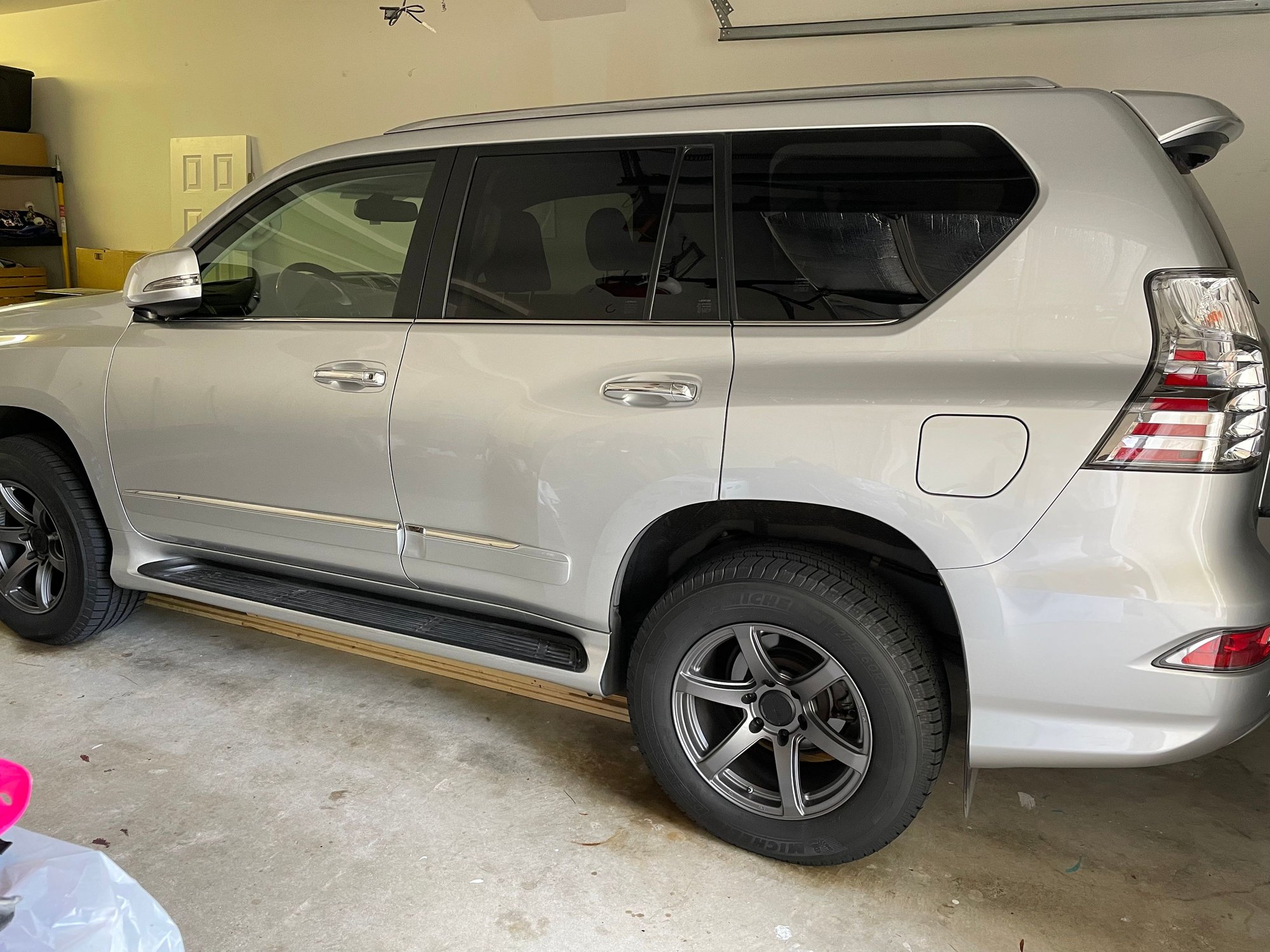

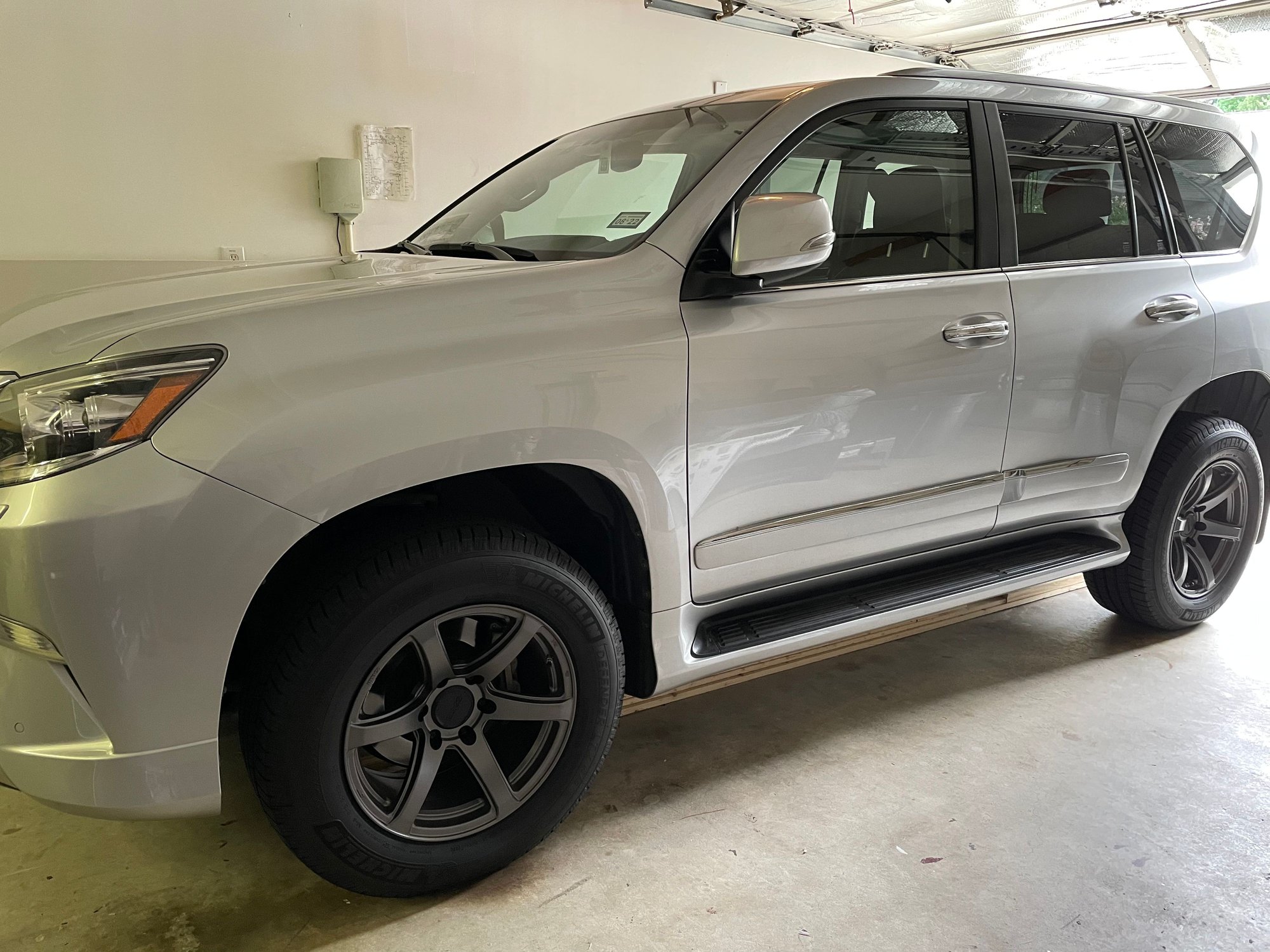

Not the best pics but gives you an idea and they have a slight poke. Couldn’t figure out what measurements would make them perfectly flush with the fenders.
Now that is a perfect stance ... commanding while not being aggressive ...
