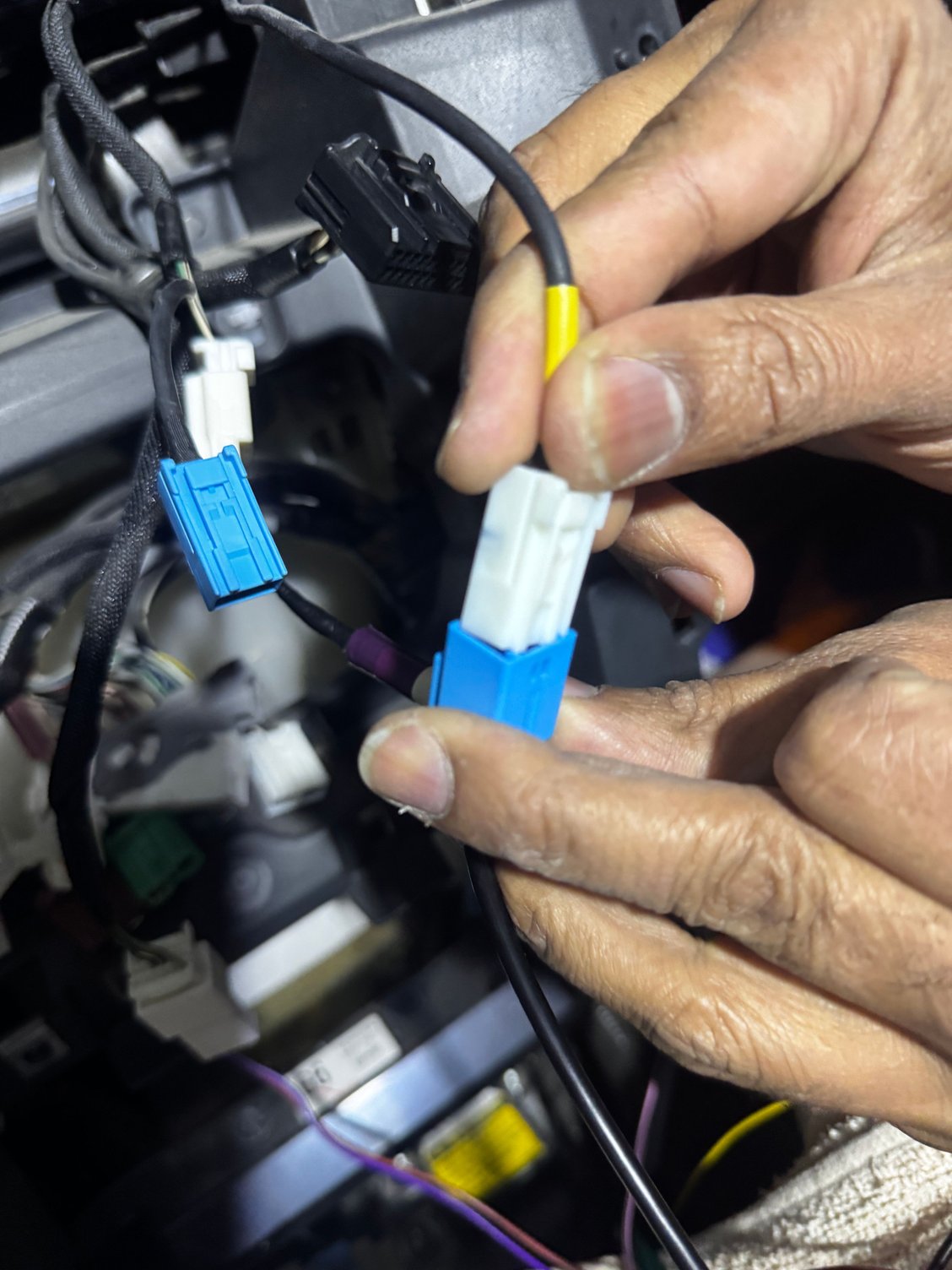

I recently ordered and received the 128GB storage, 8GB RAM Lexus GX460 (2010–2021) CarPlay Multimedia system for my car, a 2014 GCC spec with four cameras. After installation, I noticed that none of the cameras are working—there’s no signal coming through.
During the installation process, Carlinklife provided great support. They advised connecting the blue connector from the 360 decoding box to the white connector of the OEM system. Though it was a bit challenging, I managed to make it work with some modifications. However, when checking
other installation videos, I noticed that most people connect the blue connector from the 360 decoding box to the blue connector of the OEM system, not the white one.
I haven’t tried this yet. Could anyone advise if this might be the solution or if there are other troubleshooting steps I should consider to resolve the camera signal issue?
Thanks in advance for your guidance!
