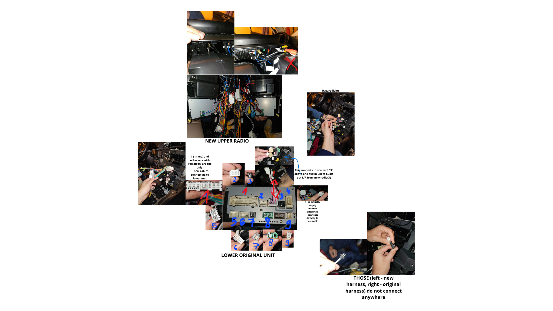

so I installed 12.3 screen but i do not have sound. All connections are shown in picture hope you can see it clearly.
Also i cannot get clear answer from chinese what settings i need to adjust to get sound.
Thanks in advance

different gx use different harnesses for these. you sure you have the correct version harness for your gx?
I really have no idea i mean this biggest one(Red 1 in picture) fits original one.
