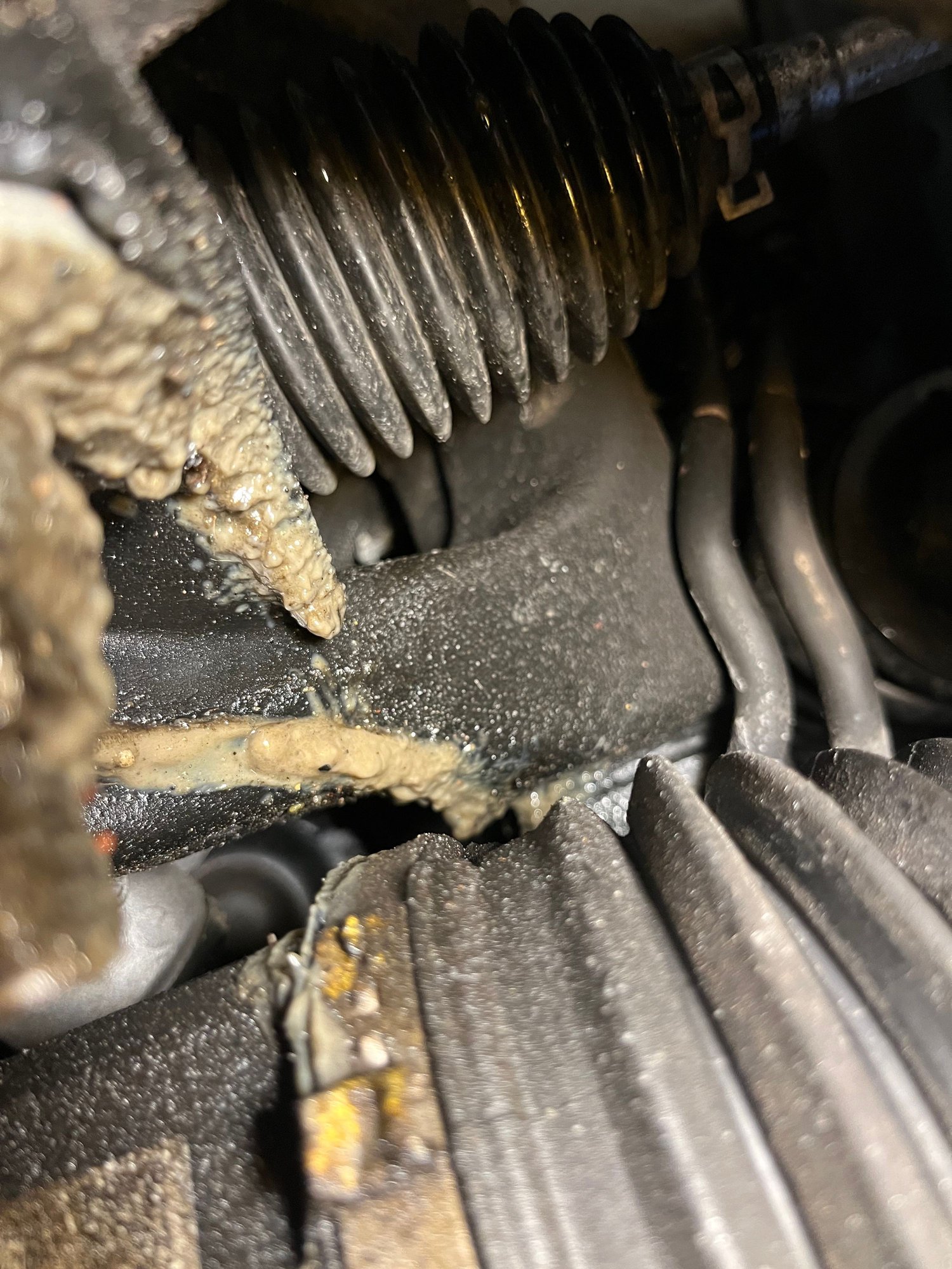

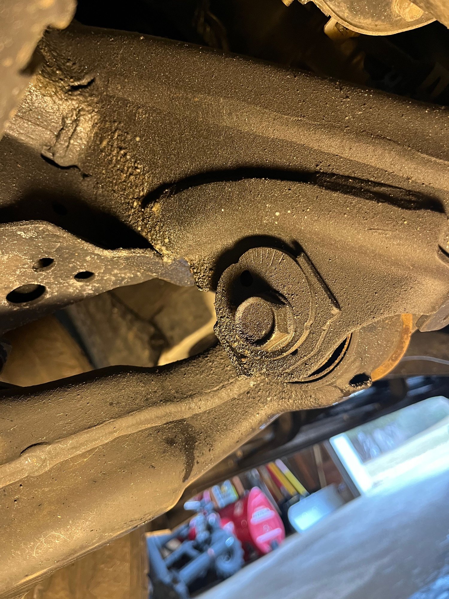

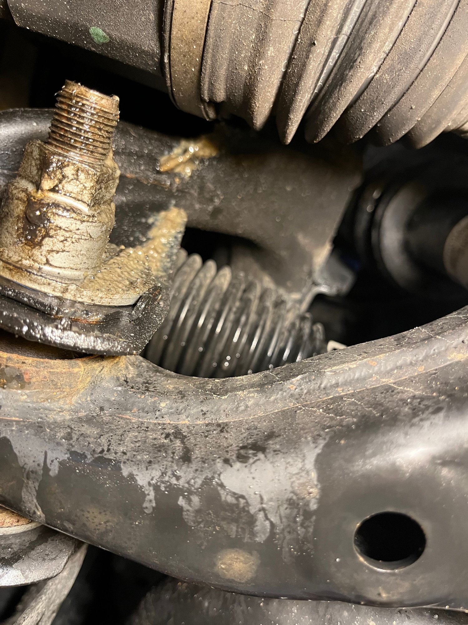

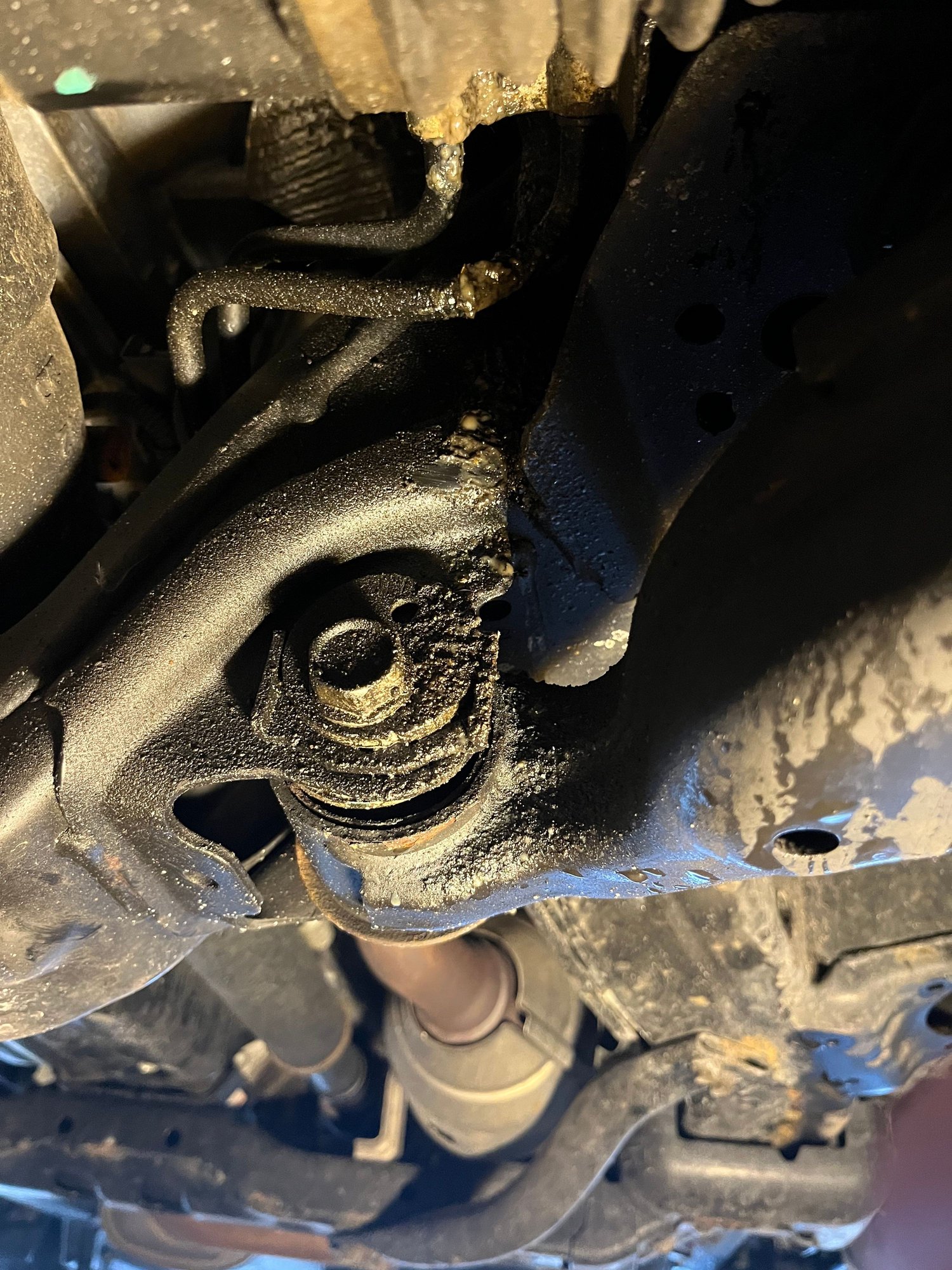

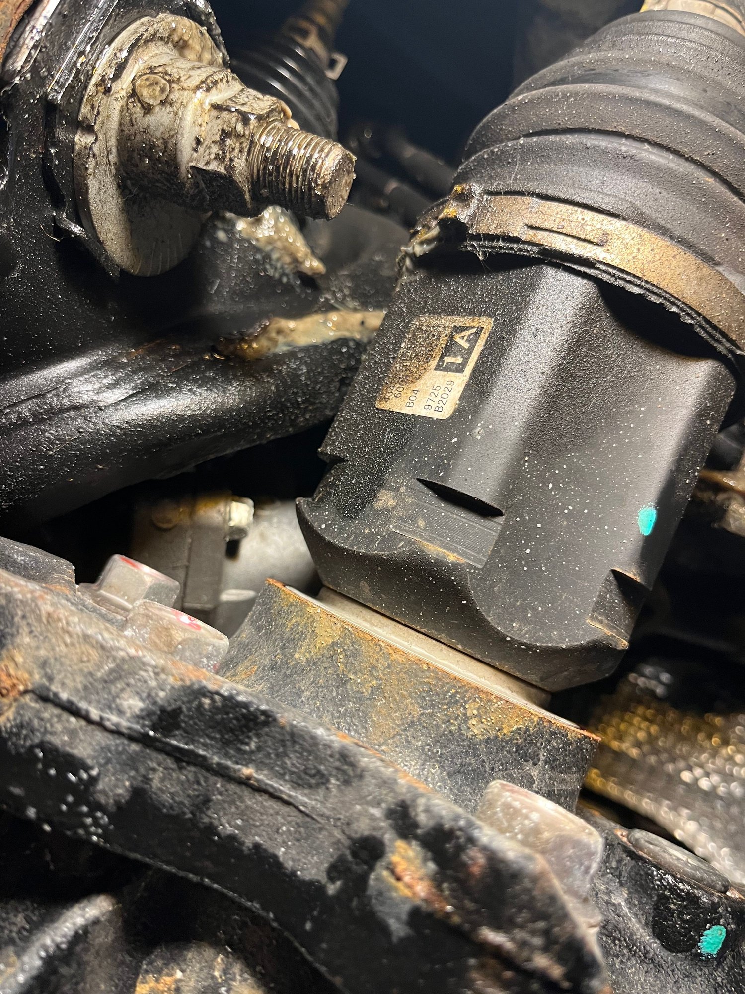

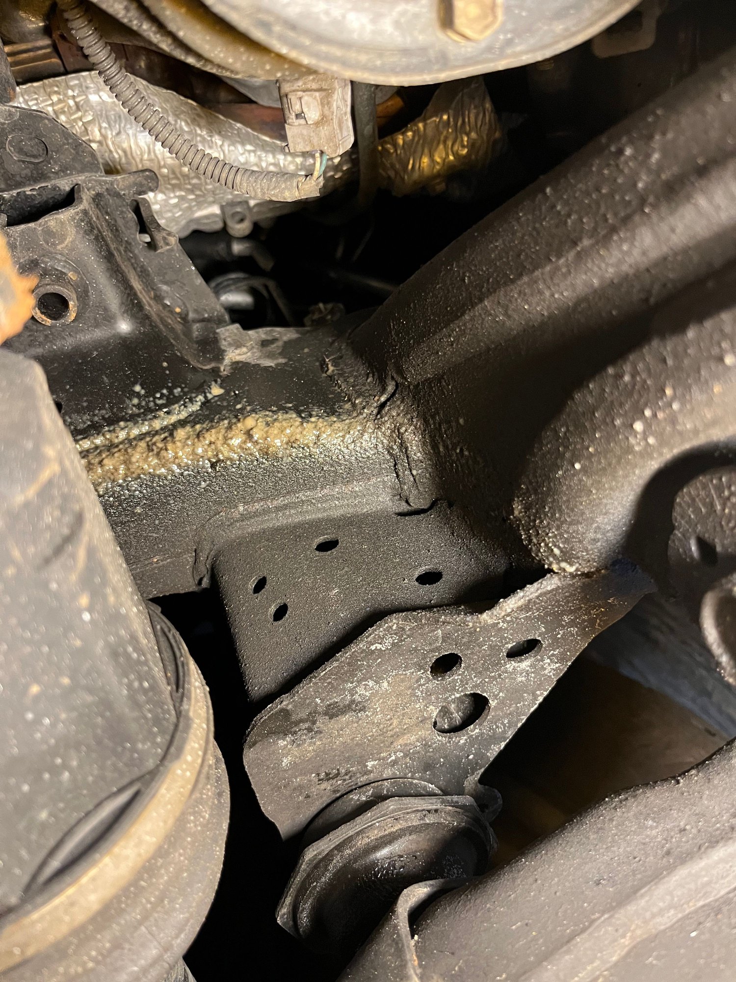

Default 2019 GX460 CV grease fling
I recently picked up a 2019 GX460. Mint with 31K miles on it.
I pulled the skid plate off today in order to replace the front dif. and transfer case oil. I noticed what appears to be grease which has been flung from the CV joints in a nice stripe on all parts in its path. Both sides are exactly the same. The boots are in perfect shape, no tears or cracks, as expected for this low mileage. Clamps appear to be in place and just fine as well.
Has anyone noticed this on their GX? Just wondering if this is overgreasing from the factory and it has to go somewhere, or if I need to call the stealership.
The pics are not the best but.....
Thanks.

Maybe someone applied a rust preventative like Fluid Film some areas are the colour of FF. If not then don't know what's going on here have not seen a leak quite like that.
Its definitely not rust preventive. It wipes right off and is slippery like grease. It’s also in a perfect like as if it was flung right out of the large end of the boot.

Check the boots closely, a tear in the 4Runner is very common and often appears at the narrow end of the boot, I am sure it would be the same in the GX.
Use your fingers to feel in all the grooves of the boot. I just discovered the exact same thing on my son's 4Runner over the weekend
Thanks. I’ll have to look closely again sometime soon. I’ll report back with findings.
