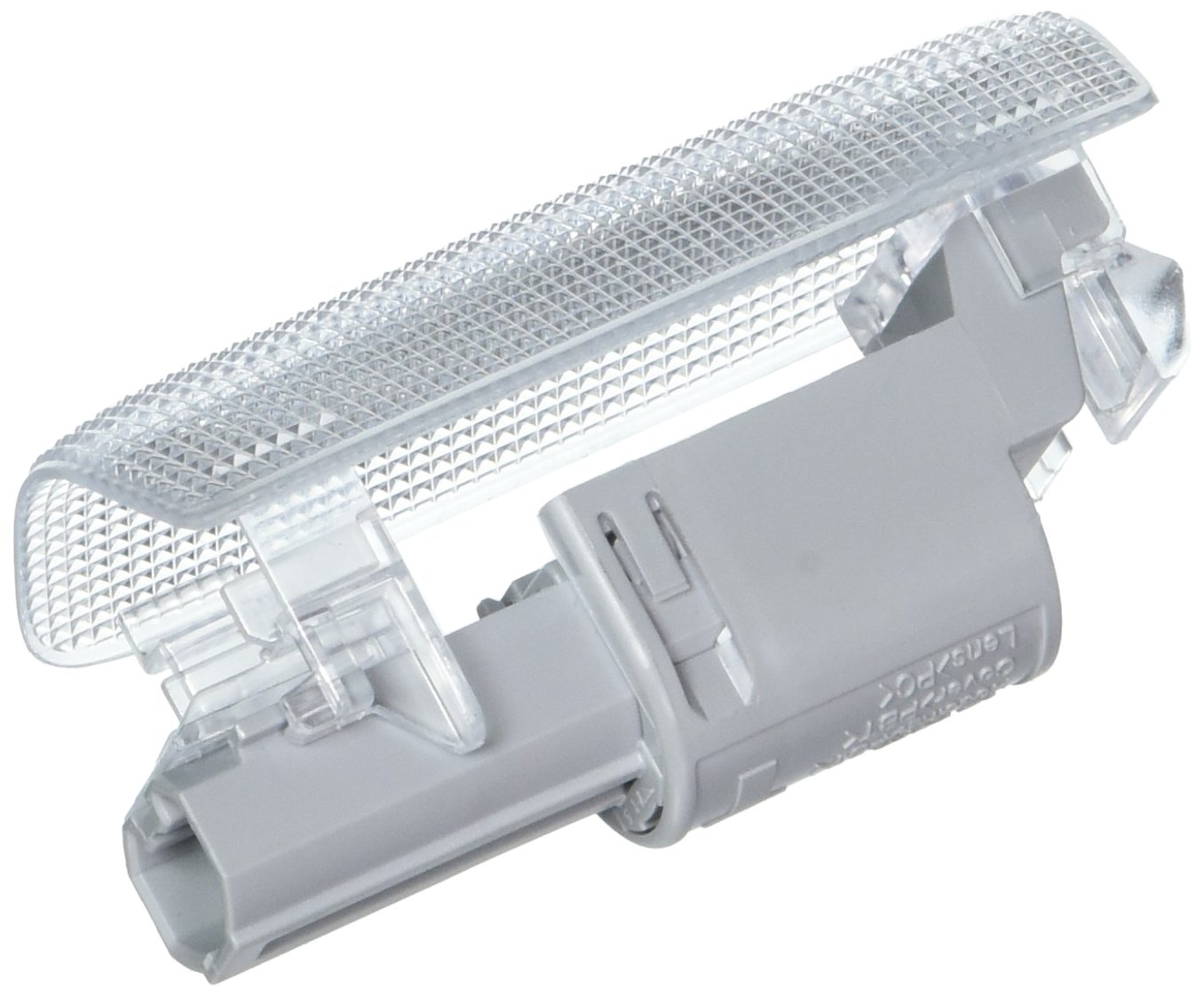

Thanks for all the tips. I got my v-leds today and swapped the running board lights out in about 5 minutes. Any tips for replacing the door/puddle lights? I took my pry tool to the lens but couldn’t see any easy way to swap the bulbs. I thought I’d check before I Fubar anything. Thanks!

I can't find the pics of how I did it but if I remember correctly you remove the clear/opaque cover then the grey housing opens up when you release the clips in the center and the bulb is in there.. I broke 2 of mine at the clips that hold it in the door when I was removing them so they wouldn't stay in the door when I tried reinstalling them. Had to buy new ones. Here's a link to the the one I bought:

Edit: I don't have any pics of opening it up, but I do have a pic of it hanging from my door after I broke the clips:

You need to release the clips to remove the lens

Thank you both for the tips! Once I realized I needed to pry the entire housing out, and then release the cover to access the bulb, it went easy peasy. Swapped out my rear hatch light to 194 LED's as well, huge improvement in light! Need to order a few more 194's for the rest of the interior domes.
