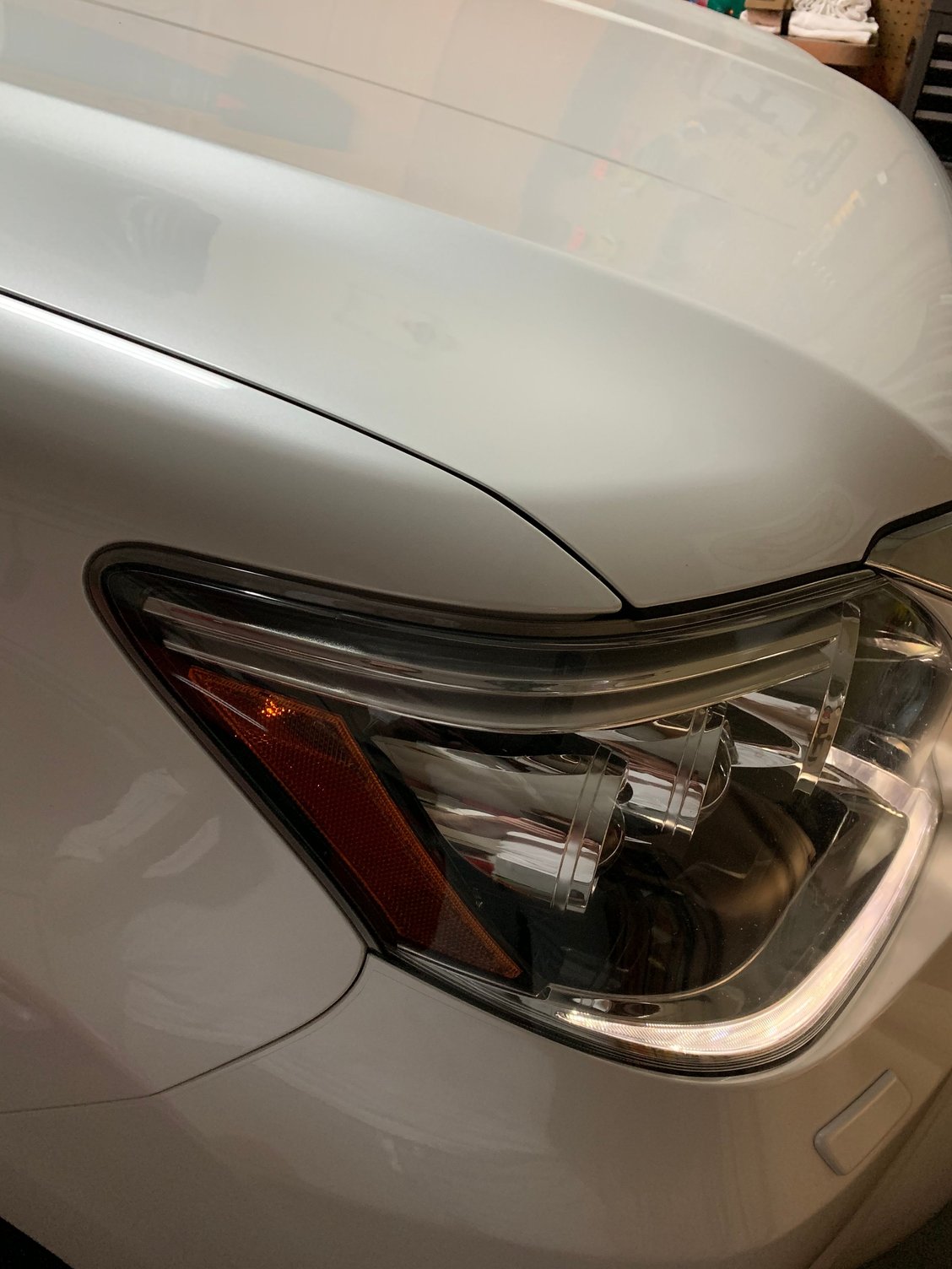

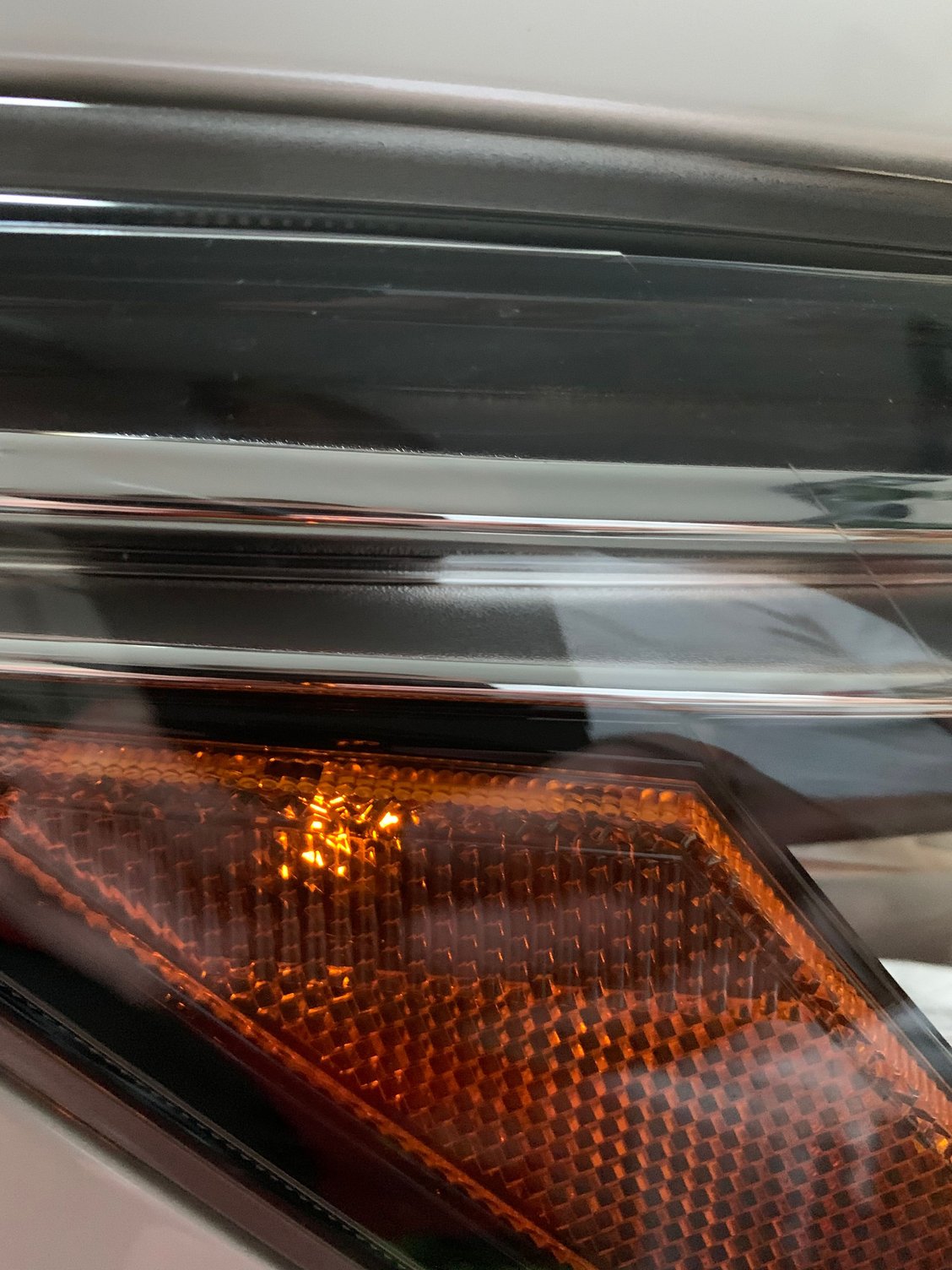

I just picked up a 2016 GX with the luxury package and the passenger side parking light appears to have fallen inside the headlight housing. It is my understanding that this light is a LED and cannot be changed but is there a way to open the headlight housing and reposition the parking light LED? The LED is still working as I can see a faint orange glow but it has fallen behind something and appears to be angled down towards the front of the car. The driver’s
side is bright orange like normal, of course.
I searched for help but the only thing I could find was confirmation that the light is a LED. Has anyone else had this happen or has anyone ever opened the headlight housing? If you remove the screws around the edge of the back of the headlight housing will the black plastic backing of the headlight housing come off just by releasing the tabs around the clear lens? Any help is appreciated. Thanks!
Passenger side
Passenger side - appears to be angled down towards from of car
Driver’s side for reference

That's the side marker light - a mandated safety requirement in the US.
If your car is under warranty, then the dealer should resolve this. If the dealer says "the bulb isn't covered" then tell them that the problem isn't the bulb but the housing - which should be covered.

Update - The dealership said they had never seen this issue on a GX, confirmed the LED could not be replaced, and thought they may be able to disassemble the headlight housing and reposition the LED as they have done on a few other models. Unfortunately, this was not the case after the headlight was removed from the vehicle and they quoted me $1700 for parts and labor to replace the entire headlight assembly. After explaining to them that the warranty was only expired for mileage and not for time and that this was clearly a manufacturing defect because the vehicle has no prior collision damage, they said they would get back with me. A little while later I received a call that the entire headlight would be replaced at no cost to me. When I picked up the vehicle the $0 invoice I got stated “WARRANTY” and has a goodwill authorization number next to it. It appears that Lexus either paid to replace the headlight or at least assisted the dealership with the cost. I am grateful my dealership handled this like everything else for me the last 15 years and for your advice, cb1111, on how to handle this situation with them. Thanks, again!
