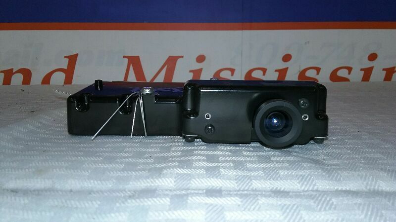

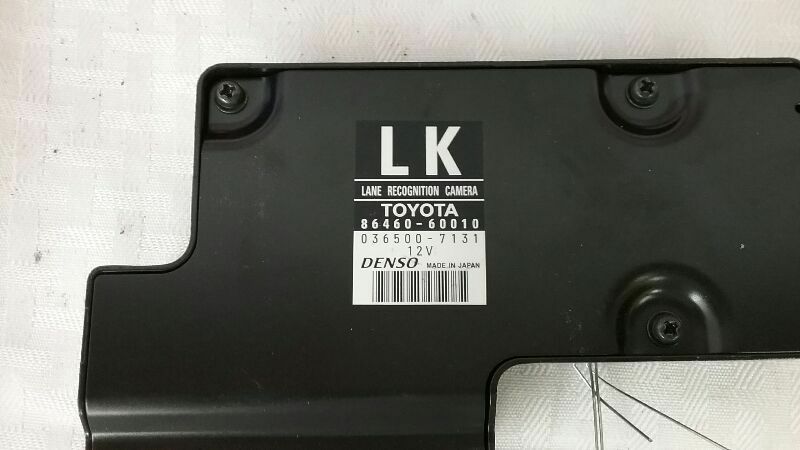

https://parts.lexus.com/p/Lexus__GX-...646060010.html

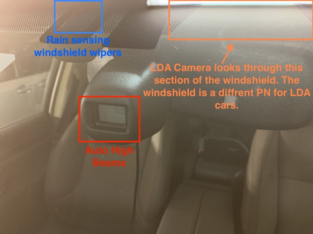

EDIT: Added rain sensing windshield wipers sensor location.

Thanks! That's a good trivia piece too about windshield that vehicle is optioned with Driver Support.
Yeah, no problem. Theres also a different headliner to support the opening of the LDA out the front of the windshield. Also the part you posted showing the LDA camera is missing the metal mounting bracket. That bracket cannot be purchased separately, Lexus only sells the bracket with the camera.

I found on one of the online parts sites. They probably figure replacement of failed unit to exclude bracket but not likely too many failed units on a rare option. If vehicle was damaged to this extent it would likely find itself again in the wrecking yard or crushed.

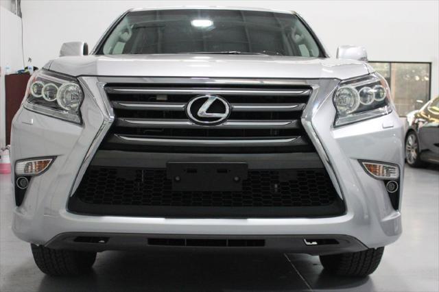

https://www.cstatic-images.com/super...10b26a734d.jpg
https://www.cars.com/vehicledetail/d...8057/overview/
DRIVER SUPPORT PACKAGE W/MARK LEVINSO...
he lists Driver supprot package.. but if u look at the pics.. u cant spot the front camera below the L symbol ??
also steering wheel. right side.. no indication ??
so he is lying ??
so he is lying ??
Clearly, he is misinformed! Definitely does NOT have Driver Support.
