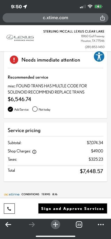

One more transmission failure to report. 2017 GX Premium with 144k and factory fluid - mainly freeway miles, but lots of stop-n-go traffic and steep inclines on my daily rush-hour drives (both ways ). Wearing 265/65/18 KO2's since approx 40k (slightly larger diameter than 60's and weigh a TON, but Speedometer tracks correctly against GPS).
The transmission began having issues down-shifting from 5th/6th down to 4th when accelerating. The engine would rev to redline as soon as it down-shifted to 4th - requiring me to let off the gas and allow it to up-shift into 5th. Regular driving shifting in-order 3>4>5>6 was good. The next day (this past Weds), it began slipping some in other gears, but remained driveable at speed. On the 3rd day (Thursday), once it got up to operating temp, I was slipping in all gears and had to shift to 4-Lo to even get any movement (!). Had to turn-around on my way to work, and was able to limp to the Lexus dealership at 25MPH just before they closed. I was waiting for the smoke - but none ever came.
Dealer reported multiple solenoid codes (but strangely no CEL or any dash lights at all!) , and transmission replacement was suggested.
Luckily, I have a CPO + 5-yr unlimited mileage Lexus warranty (good til Nov '24), so that $6550 repair isn't costing me a dime. I also had my radiator replaced under the extended warranty a few months ago (was leaking at the top by the hose - a $1000+ repair). Paid ~$2k for the warranty when I bought it as a CPO in 2019, and used it for $7500 in repairs the past few months Previously had a 2013 T4R I bought new in Dec 2012, drove it for 265k with ZERO major repairs, and never used the 4-year extended warranty on it - so I was "on the fence" about buying the $2K extended warranty for the GX CPO - boy am I glad I did!

Assuming that’s aimed at me. The slipping/redlining when downshifting to fourth gear was the first sign, experienced that for a day or so (110 miles round trip). Then it was slipping in a few other gears on the way home the next day. And then the very next day, after it heated up, I was basically sunk in the water. So it all happened within four days / approx 250 miles.

I don't understand this " I have a CPO + 5-yr unlimited mileage Lexus warranty (good til Nov '24)". You have a 2017 that you bought CPO in 2019. The CPO kicks in after the original factory expires. That means you had at least a year of factory (assuming you bought it end of 2019 and the original owners first use was start of 2017 and you didn't hit 50k miles on the clock). In that case you would have 1 + 2 + 5 = 8 years of coverage to 2027. Even if you bought with over 50k you would still have 7 years. That would take you to 2026. Do you really mean you added a 3 year VSA to the CPO for a total of 5 years?
Also $6500 for a new transmission with installation isn't too bad. I would have thought it would be way more.

Lexus reman AT with reportedly all new internals except for re-used transmission case is $3,375 + labor
https://www.oemvehicleparts.com/oem-...n-3501035b7084
There have been some inventory backlogs. Not sure if that still exists right now.
Wow that is amazing - so even if AT catastrophic failure, cost to replace won't be deal breaker.

Oh - looks like it is really $4,375 - something about a $1k 'core charge'

You will get that extra $1k core charge back in exchange for your old transmission so they can reuse the case.
Labor charge to remove and install will obviously vary from dealer to private shop.

Bolded part is likely correct - Will check the warranty paperwork and confirm. I know I paid about $2k for the warranty in 2019, and have bumper-to-bumper unlimited mileage warranty until November 2024 Paid for itself almost 4x now...
