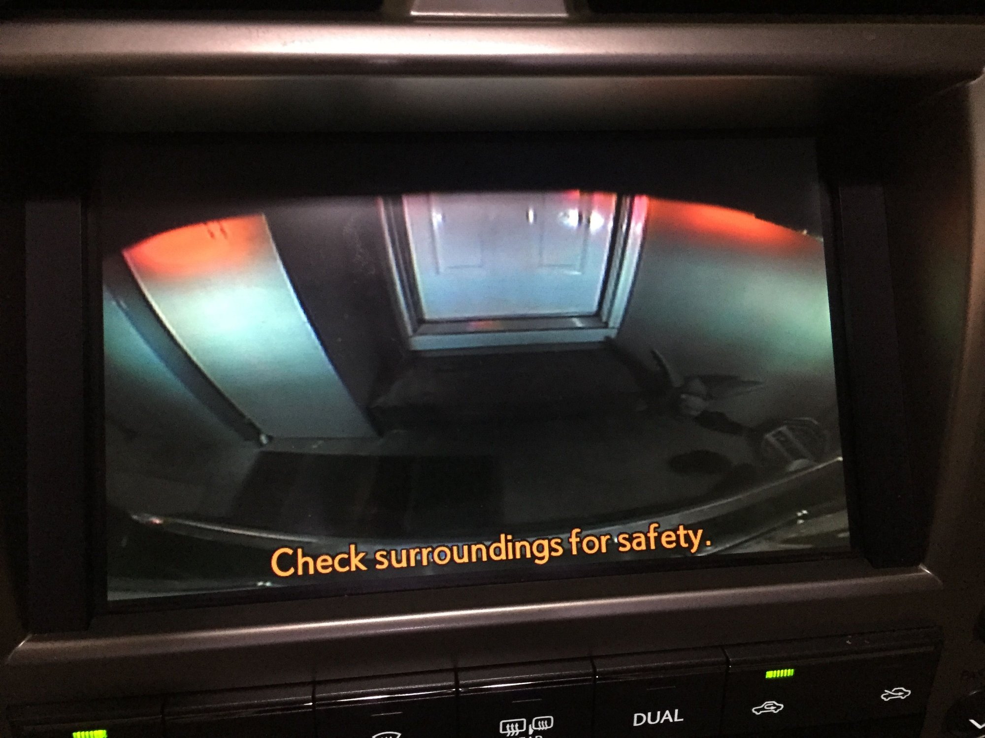

I have been dealing with this black arc on the top of the screen after I had the rear gate repainted. I went back to the shop and was told that there are no adjustments for the back up camera, OK but I never had this before. Advised I can leave my GX with them for half a day so they can remove the gate panel to access the camera, I said I will figure it out so no thanks.
I keep putting this off and it is occasionally annoying. If I push on the camera it does move so not sure if the bracket got bent or if there are possible adjustments.

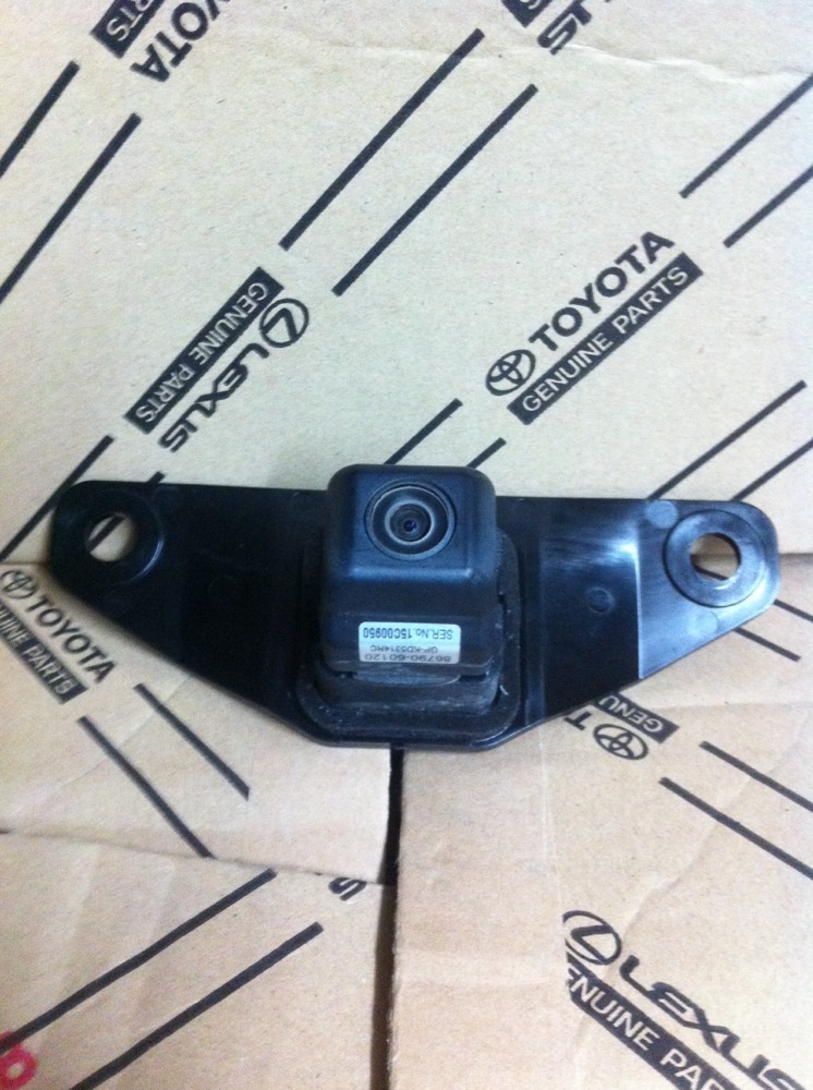

If it looks like this:
then maybe you can loosen the bolts and move it then re-tighten. Else could sideways drill out the holes in the direction you need.

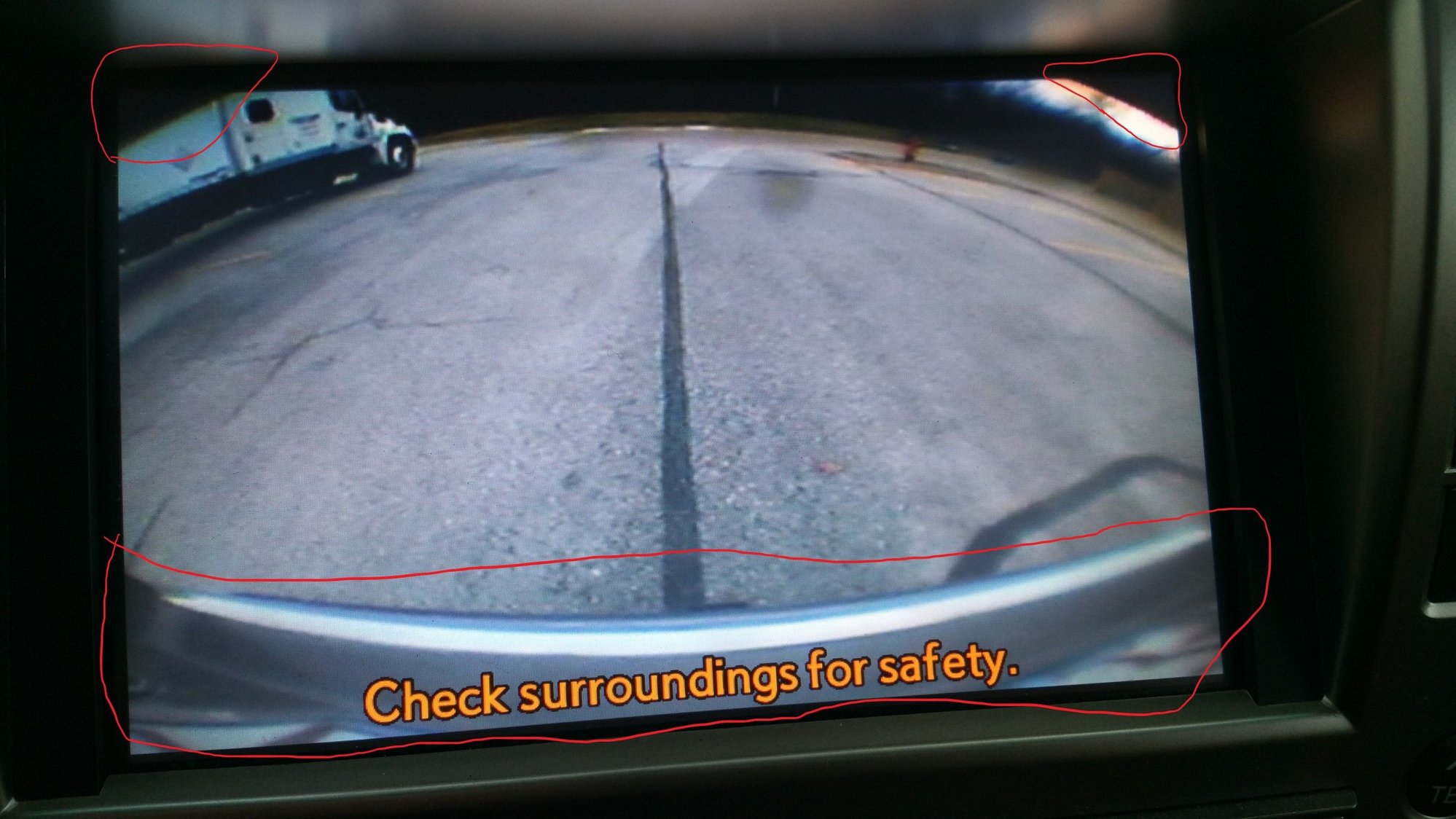

I looked at my image, I don't have that on top except for the uppermost right corner can barely see it. They probably think you should be looking at the bottom of the screen anyways. I'm sure it can be adjusted if you think it is worth the work.

Theres mine. it would take moving it farther out (away from the vehicle) to get rid of the red areas that are my gx. I would at least keep part of the bumper visible.
