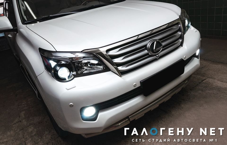

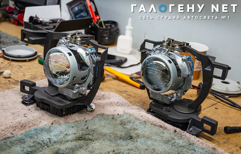

Interesting conversion here on 10-13 models to BiLED and maintains AFS.
https://www.drive2.ru/o/b/542012229445222608/
https://www.galogenu.net/

Those guys seem to be VERY talented! Their site has some really nice work on it. Too bad nothing for GX460 that I could find. Also wonder if they even ship international
