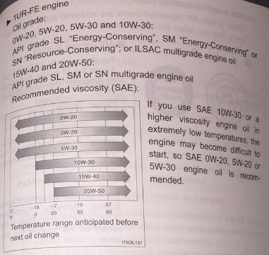

Originally Posted by Jacket
Where is the above image from?
That's every owners manual outside of the USA I believe

Originally Posted by ASE
... temperate climate ... been running 5w-30 since first oil change at 1,200 miles ... same with all Toyota vehicles purchased new ... and change every 6,000 miles ...
I am from northeast, my 2015 gx has 160k miles, I have always used 0w-20, if I were to switch to 5w-30 starting next spring/summer, would this have any issues with its 1ur fe emgine (bearing clearance etc).
My all time avg fuel economy is like 19.1mpg, I don't tow or do any off-road, most miles are on highway. So I don't really care about any drop of mpg, I do care about engine longevity.
Thank you and happy Thanksgiving!
Clearances are the spaces between parts, tolerances are the allowed amount of variation from the spec'd clearance. Mass produced automotive engines generally all have pretty similar clearances, regardless of grade spec'd. Where things change is when we get down to thinner oil grades like 0W-20, 0W-12, and 0W-8 where the MOFT just isn't there with these ultra thin oils, so the solution is to increase the bearing width, to increase its load carrying capacity and provide a larger film over which the load is spread. This increases friction of course, but apparently the increase in friction here is less than the overall savings by going with the thinner oil when looked at as a whole. This was heavily experimented with in Japan long before it made its way to North America.
So after reading all that whats the take away? You are absolutely fine running a thicker oil, as long as that oil falls into the manuals attached above in the anticipated ambient temperatures.
If you want it even simpler about running a more protective oil, just use 0w30 or 0w40 in areas where it can snow, or if its above freezing run 5w30 or 5w40.
Lastly any oil thats been tested and recommended in any 1URFE manual oil is fine. The most important thing though is regular oci paired to duty cycles.
