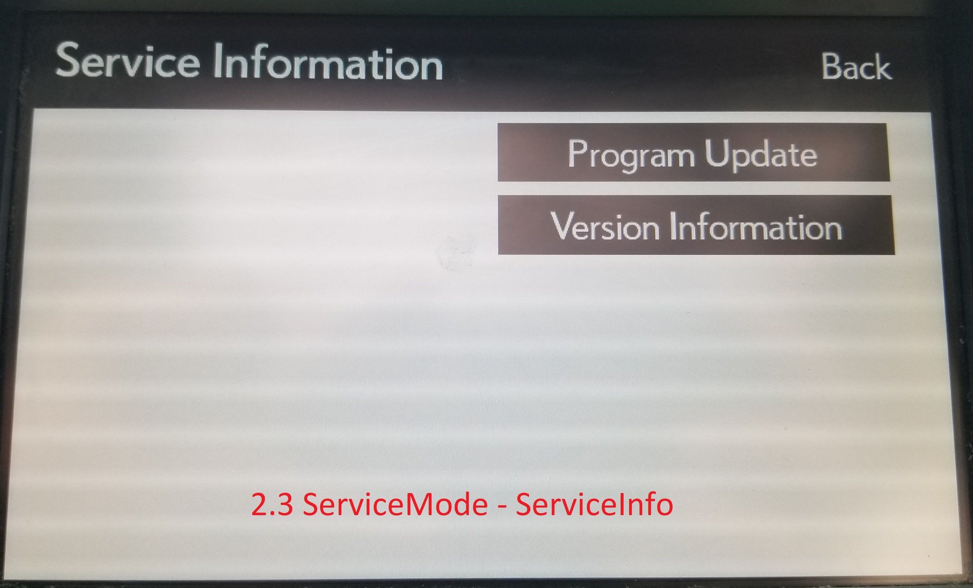

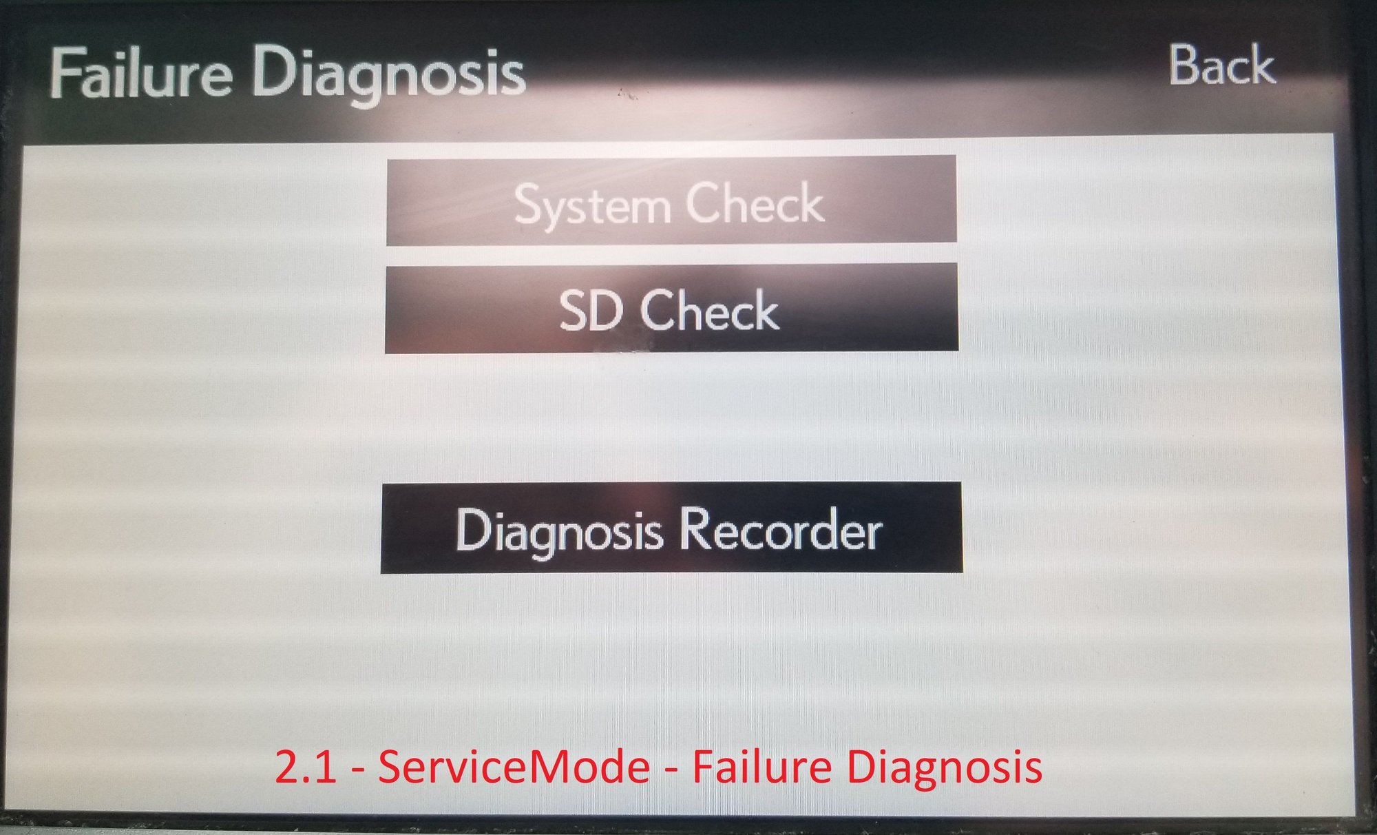

Default Service Screen
The second screen is called "Service Menu". To access hold the INFO button on the center console and turn the headlight switch from OFF to ON 3 times. You will end up at the first pic. To fully exit the service menu you must turn the car off and back on then hit OK in the 2nd picture.
Access at your own risk
Attached Thumbnails '14+ #Diagnostics-img_0802.jpg   '14+ #Diagnostics-img_0803.jpg

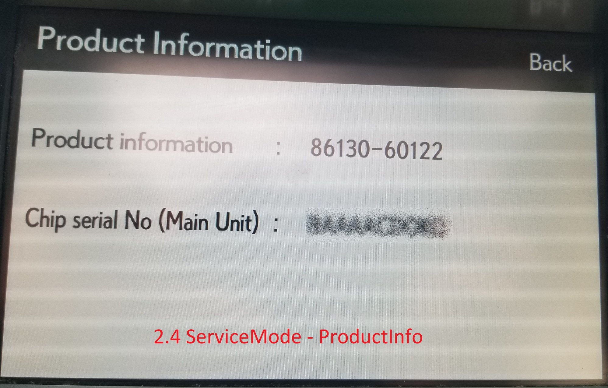

Not sure what is available for adjustment/settings. He just went into service menu for a quick check of product info and I discovered the 2nd by accident. Have not had a chance to play, maybe when the weather is warmer.

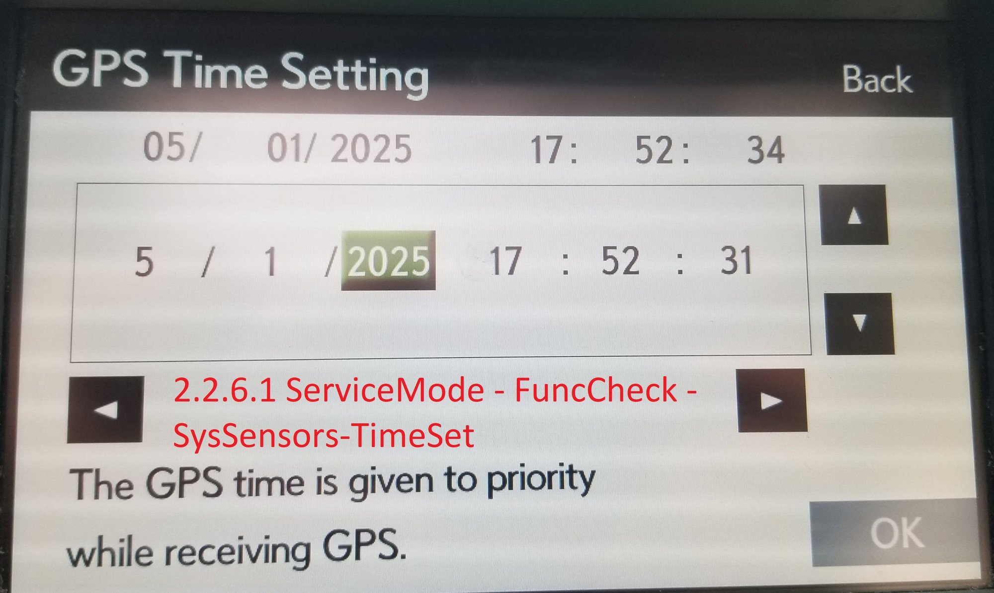

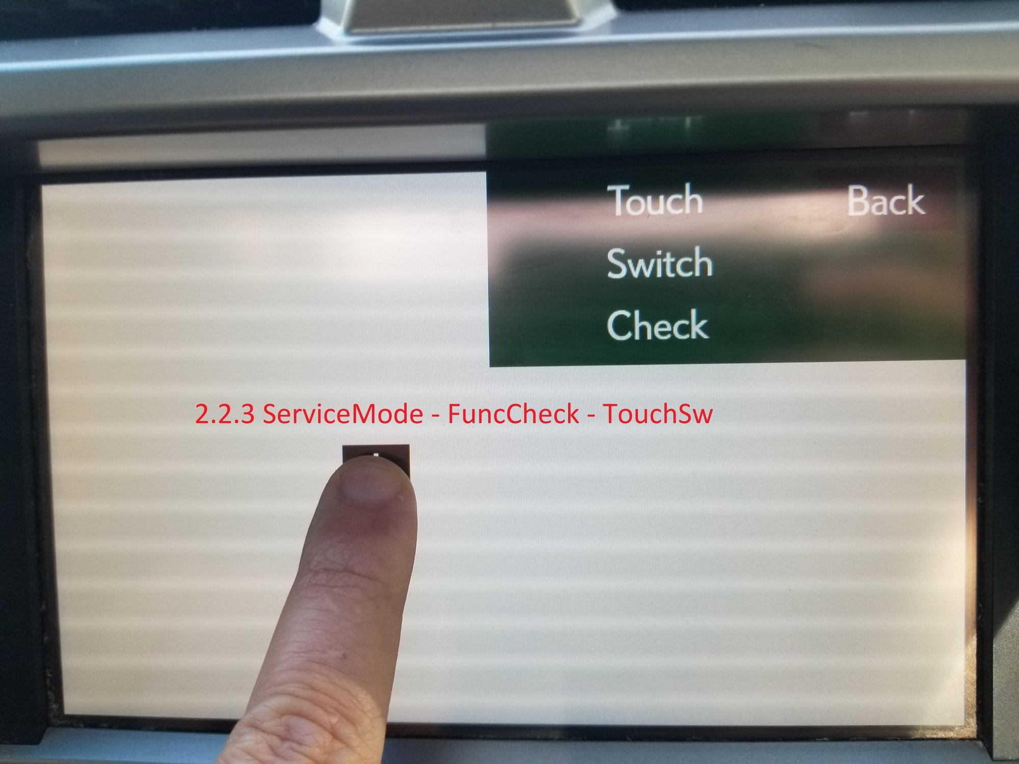

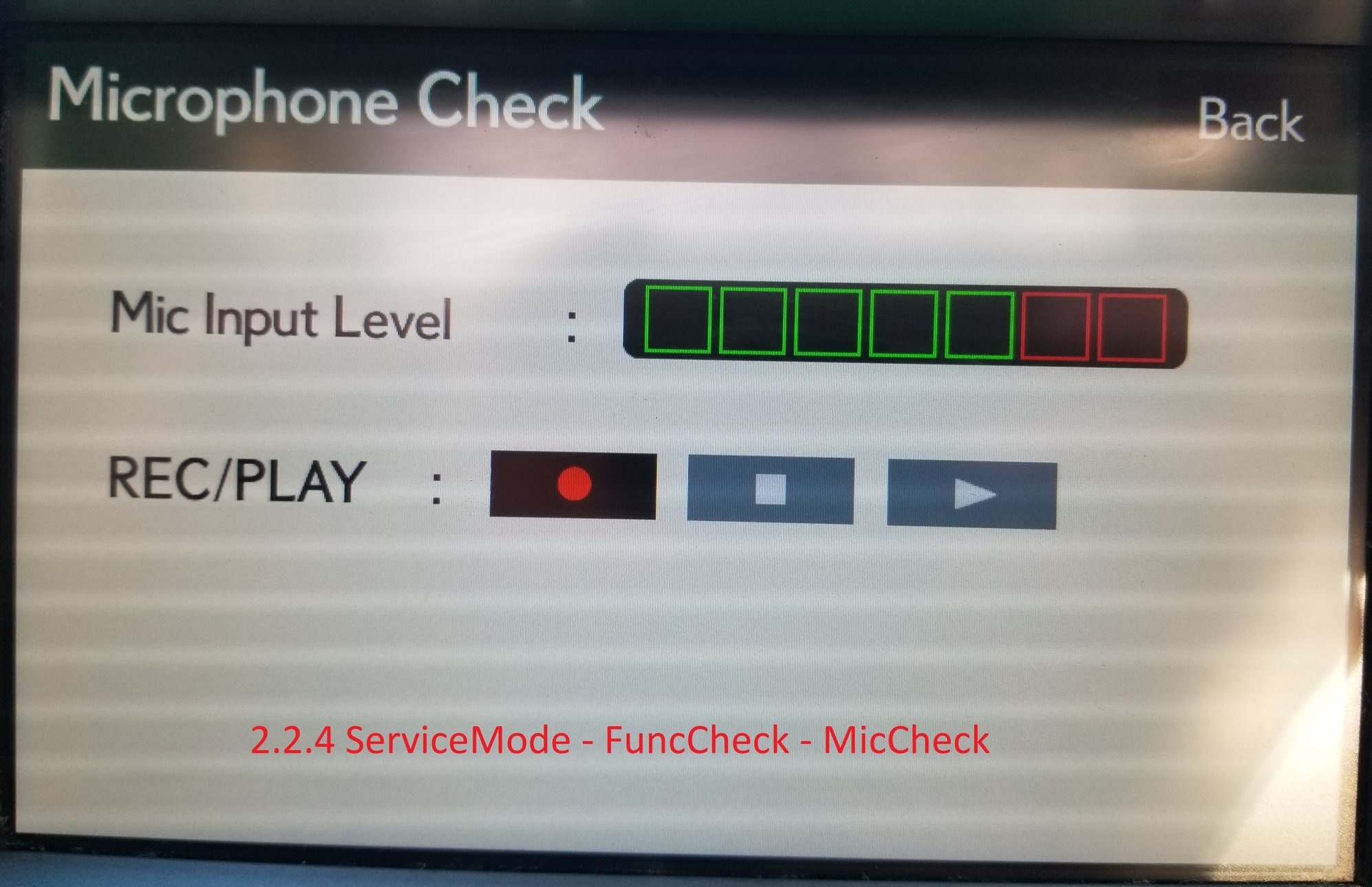

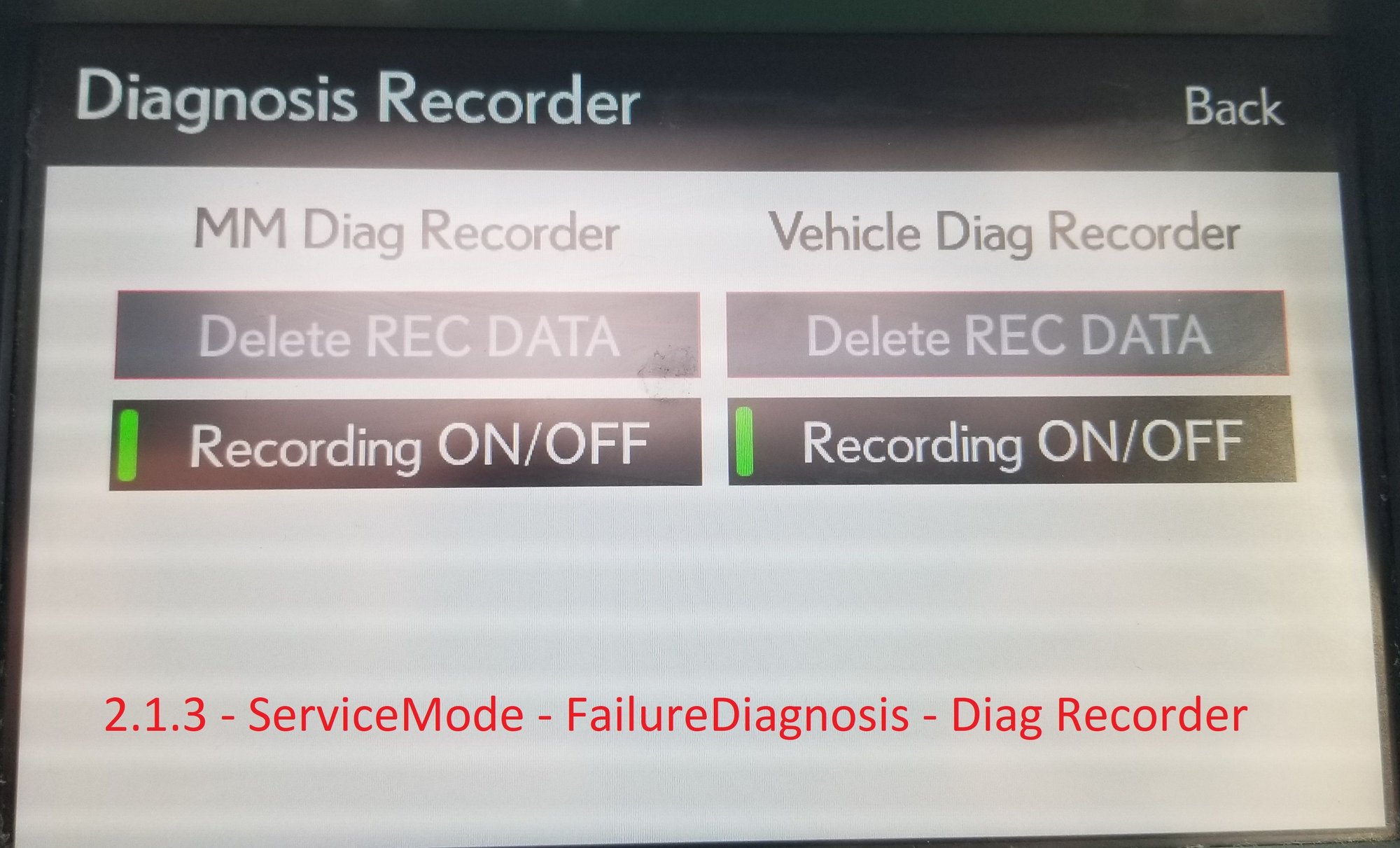

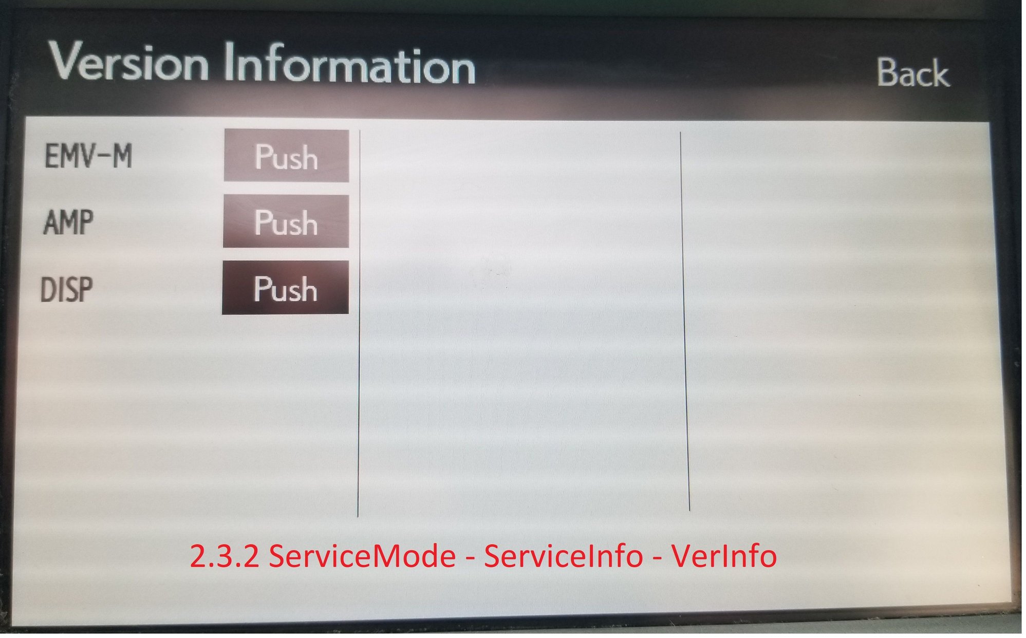

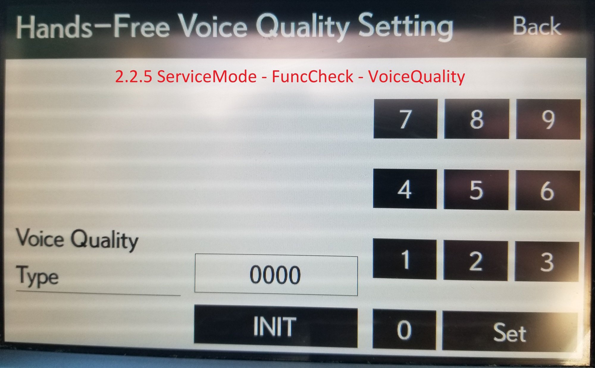

Default Detailed Diagnostic & Service Menus

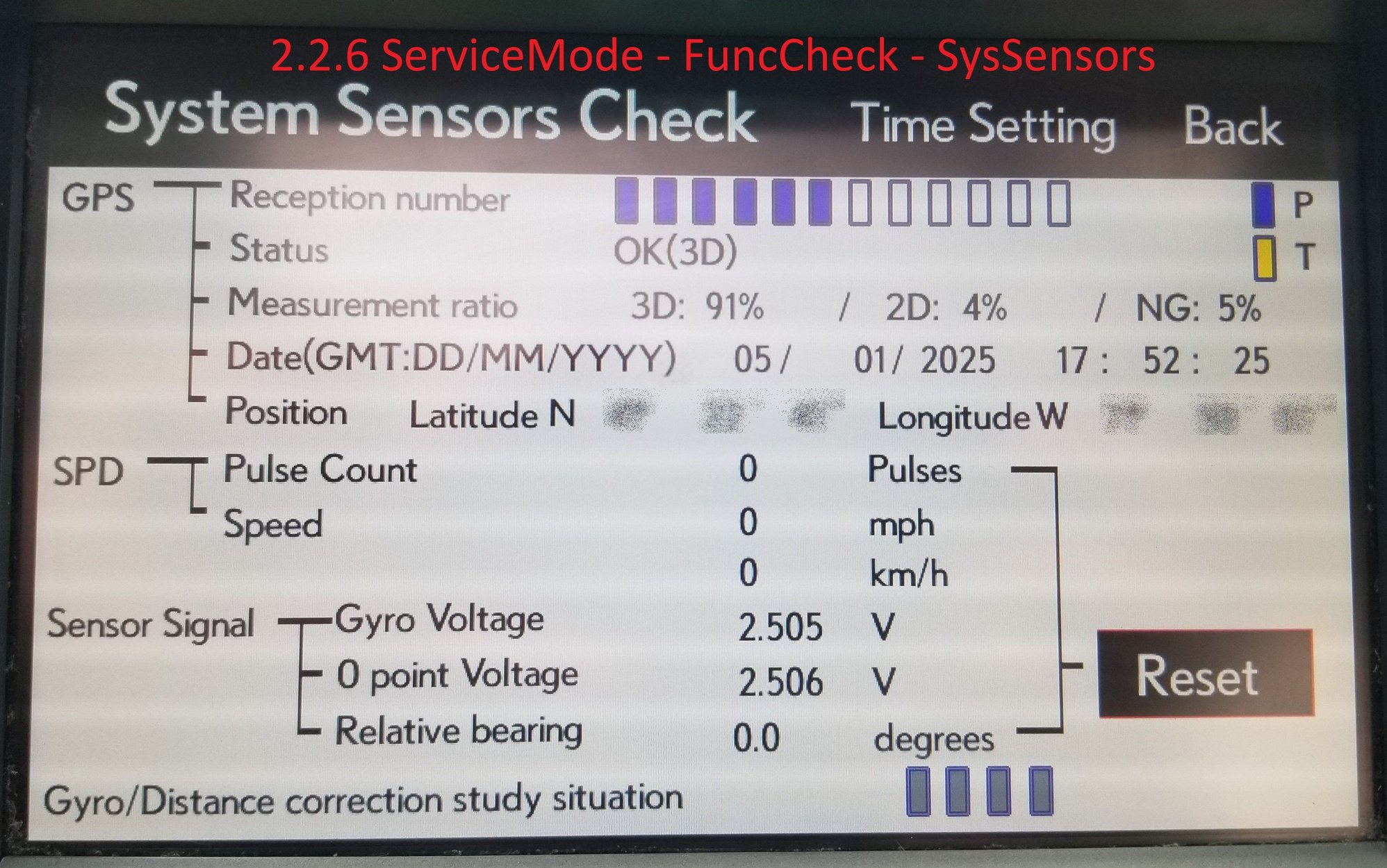

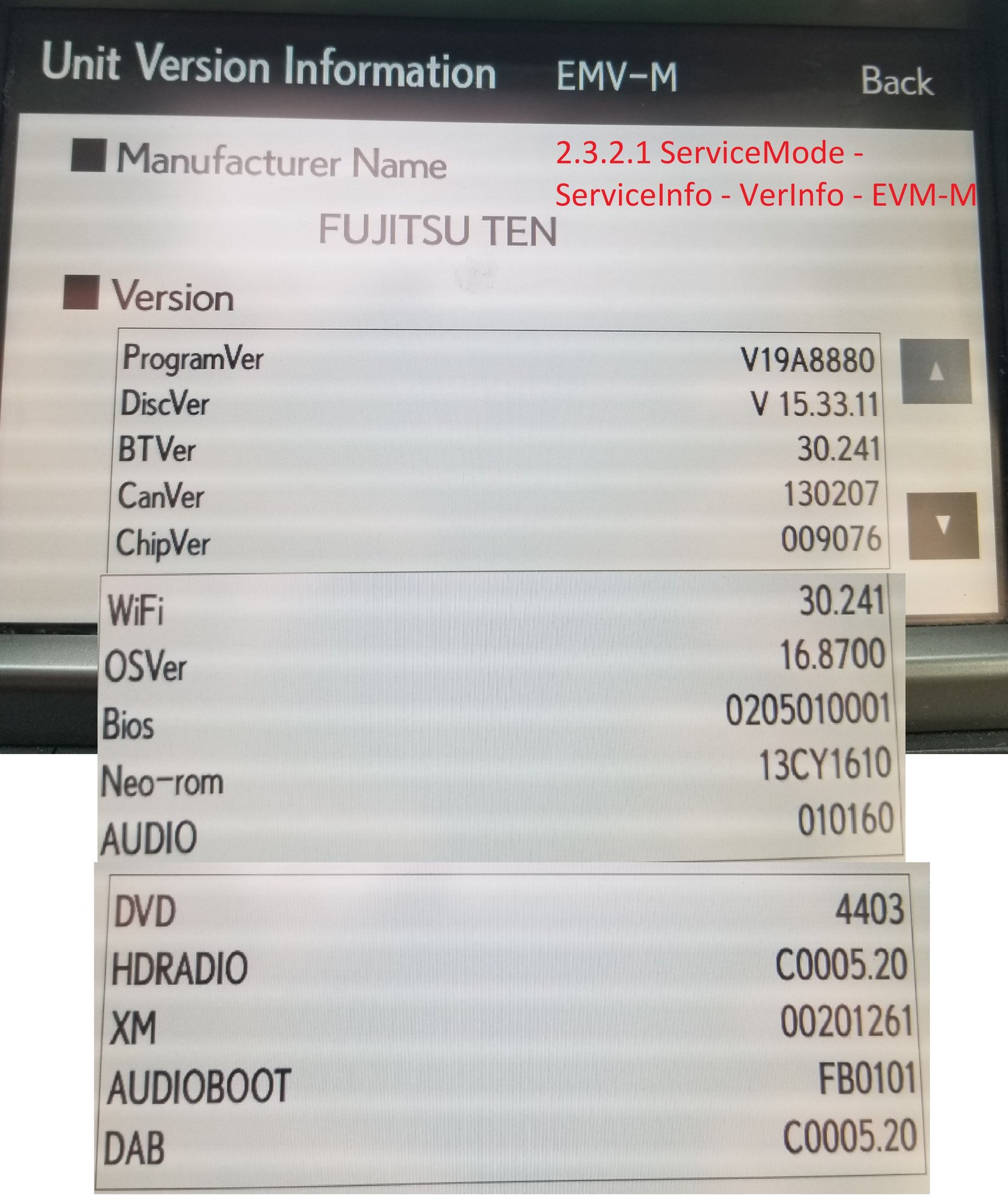

For anyone interested, pictures of the full sub menus (pulled from a 2016 Premium) are as follows:
https://imgur.com/a/cqeHFR2
