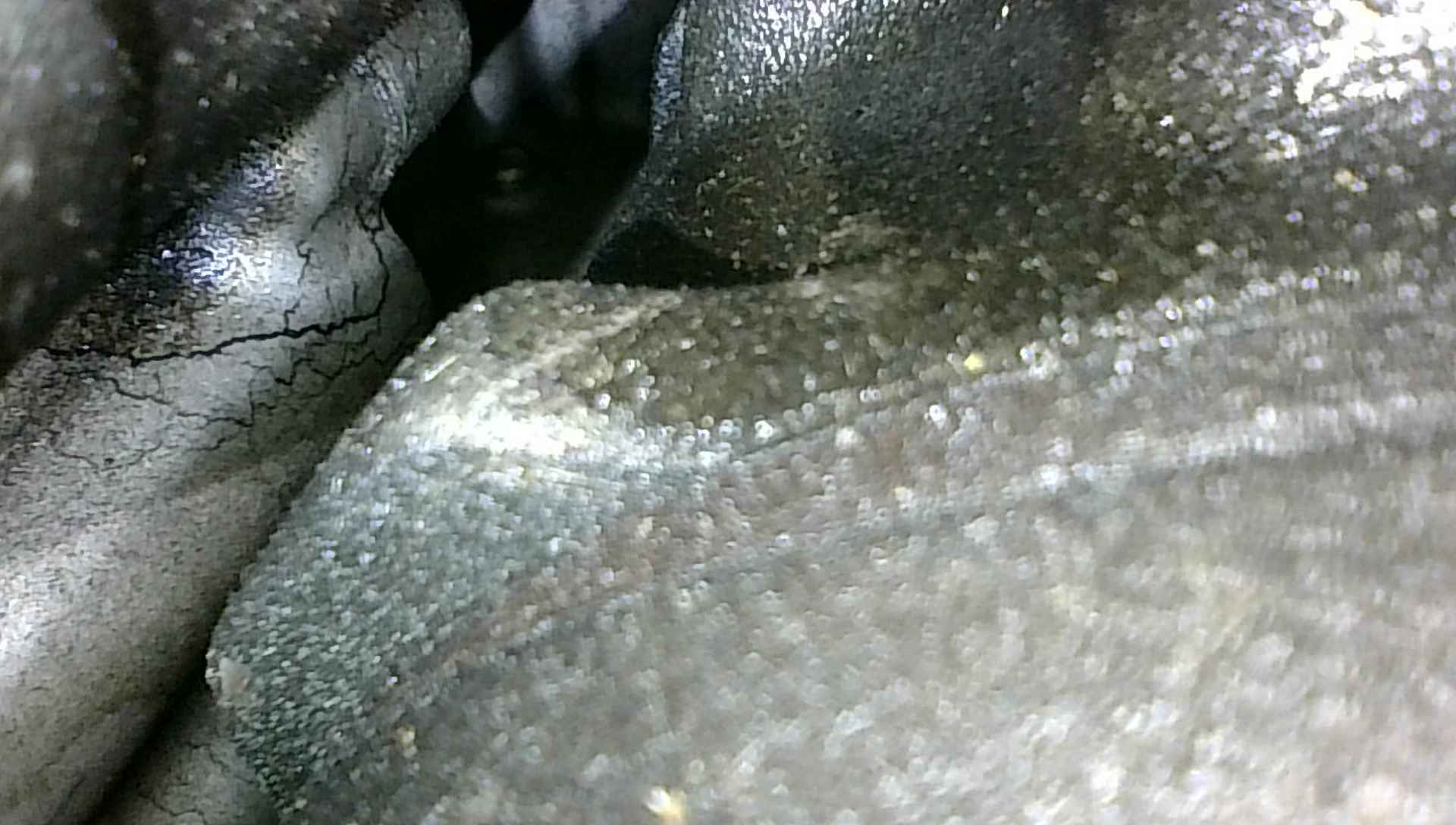

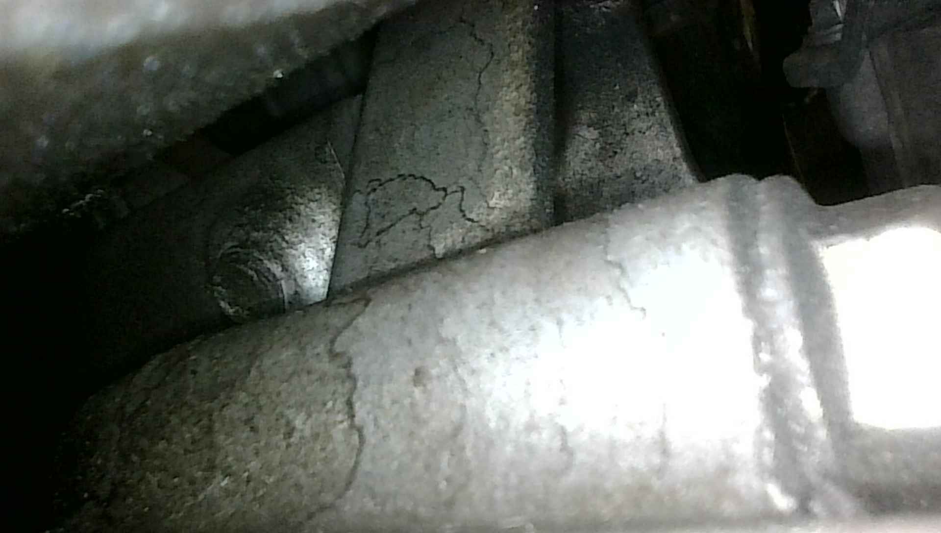

Hi everyone, new member here. I bought a 2022 GX460 a week ago from Carmax, car has 65.000 miles on it, it rides good and looks amazing, love the vehicle, I recently took it to a Toyota dealer to have it inspected and also have them do a coolant flush, after the services were performed they told me that they were no visible leaks of any kind......Once I got home I pulled out my borescope camera and found what it seems to be a leaking timing chain valve cover, I have also noticed the coolant reservoir slowly goes down on a daily basis, needles to say the dealer did a very bad job at finding those leaks. While using my borescope I also found what appears to be cracks on the timing chain cover and maybe engine block.
I'm posting this to see is anybody has seen this before and can tell me if those are cracks or just aluminum casting marks, car is no dripping oil or coolant so I'm assuming I'm dealing with the dreaded coolant valley leak besides the timing chain cover leak, any help will be really appreciate it, thanks.

What's the oil change history on this?
2022 is very young for the timing cover leak which makes me wonder if you could be battling elevated crankcase pressure due to a poor maintenance history (lax oil changes causing sticking rings/PCV valve).
This leak doesn't seem to show up until the 8-12 year normally mark due to FIPG aging.
The "cracks" just look like dirty oil/grime in casting veins, not cracks.
Personally I'd clean it up, change the PCV valve, go to a slightly heavier cleaning oil (Valvoline Restore & Protect 5W-30) and monitor for a few oil changes.
It may be a manageable weep that you can just keep an eye on over the next several years.

Carfax shows oil changes every 10k miles, I'm taking it to a Lexus dealer tomorrow to have them do a coolant pressure test on it, and also check the possibility of fixing the timing chain cover leak under Lexus powertrain warranty. Like I said the Toyota dealer did not put enough effort into finding the real issue here, hoping the Lexus dealer would.

BTW, thanks for the quick reply and clarifying that those are not cracks just dirty casting marks, I should ad that the car drives great, lots of power, no white smoke out of the exhaust, engine idles fine, no weird or tick noises, just the coolant going down and that suspicious oil leak.
